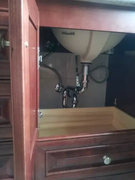

  • I added my own answer with a picture of my final design. Seems to be code compliant. – Uncle Meat Sep 27 '12 at 23:58
    Adding a second trap is more than redundant, it creates a vapor lock that will impede drainage. – The Evil Greebo Sep 28 '12 at 01:02
Here is what I ended up with. It doesn't contradict the code and inspector signed all the papers. I am not sure if he really looked at it, though.
Uncle Meat

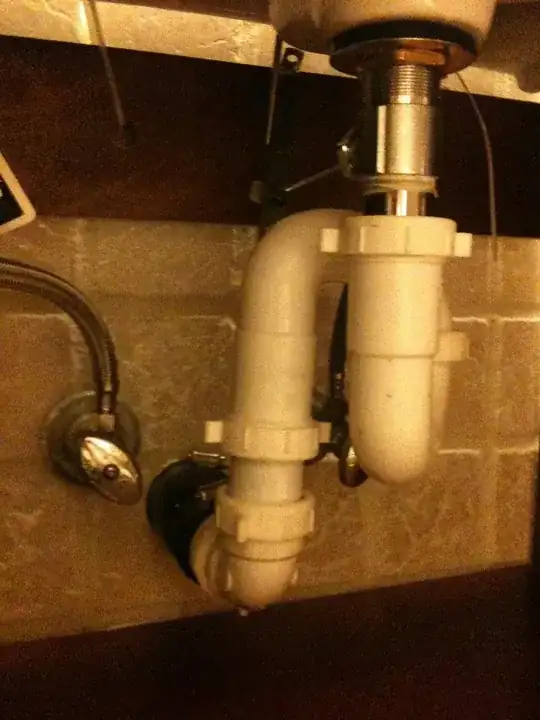

I had a similar situation to you and ended up doing what you see in the picture below. The old vanity did not have a bottom drawer, so the bottom of the p-trap was below the wall drain pipe. I got the parts necessary for this in an s-trap kit from home depot, and then got a 1' section of PVC that I cut with the miter saw to join the elbow to the trap.
sink trap
Aaron
  • 6,391
  • 38
  • 60
  • That looks good. Is it allowed by code and was it inspected? – Uncle Meat Aug 15 '12 at 14:45
    It was not inspected, I just did it myself. I brought the picture of the basin and drain outlet to the local home improvement store and this is what the workers there suggested. Seeing as how the trap is there, I don't believe it is a health hazard, but I will claim ignorance on the code aspect. – Aaron Aug 15 '12 at 15:09
    Clever solution, but this is an S trap which is prohibited by modern model codes. – bcworkz Aug 15 '12 at 21:46

  • Assuming that you replying to the original question and not the answer that shows S-trap. 1. If it is illegal anywhere, please provide at least some reference. My research as well as some others answers suggest that it is at most a grey area. Inspector saw it and didn't say anything. Similar things are used in double sinks as well. 2. Why is it more leak prone if all connections are done right? I've been using it since 2012. No leaks so far. 3. It is necessary to avoid cutting the drawer as indicated in original post. – Uncle Meat Dec 04 '21 at 01:03
