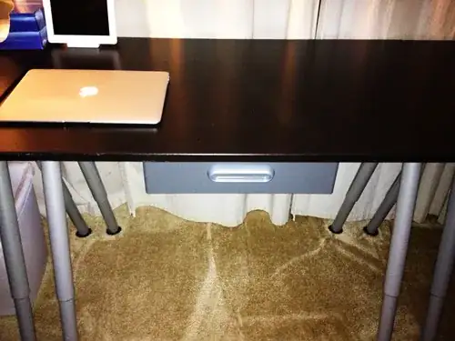

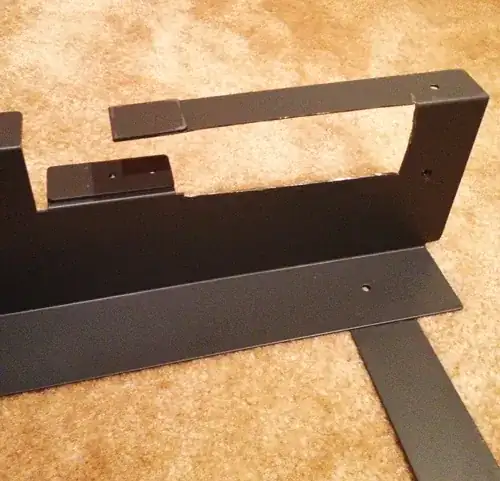

Thanks for all the help! I ended up buying a Dremel. I went through 6 cut-off wheels in order to finish all my cuts. I was customizing an IKEA drawer to fit under my smaller IKEA table. Here is one of my noob cuts:
And here is the finished product:

  • Where does the peice that needs to e cut start and end? I can't tell from the picture. That will matter for determining the best way to cut that peice out. – alx9r Aug 16 '12 at 05:37
  • Also, what size are those items? Something to indicate scale in the picture would be helpful. – alx9r Aug 16 '12 at 05:41
  • The size marked by red is about 1 inch by 2.5 inches – Kirk Ouimet Aug 16 '12 at 06:32
    That is not thin metal! That is steel and i can only think of using a grinder. If it were a sheet of metal then metal cutters/sheers would do it. – WillyWonka Aug 16 '12 at 10:42
