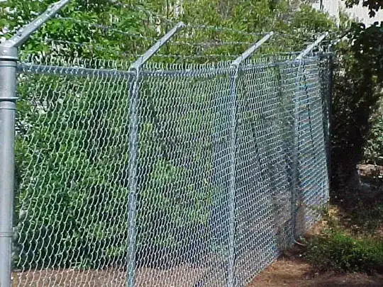

I'd get some Barbed Wire arms for the fence.
Since a picture is worth 1000 words,

  • I like your response :) Although I am against injuring an animal I sure like the idea about the barb-wire..where could I purchase this do you know? And would I be able to do this myself? Thank you again! – Kim Latchford Aug 20 '12 at 15:56
  • Check out your big box store (Lowes/Home Depot). They should have these in stock, or at least through order. I've never done it, but it looks fairly simple to do. You might need some help tensioning the wire. – Chris Cudmore Aug 20 '12 at 16:00
    The barbed wire is probably unnecessary - if you can install the angular brackets with something solid (or even just regular wire), it will prevent the dog from being able to get over without being dangerous for kids – Steven Aug 20 '12 at 16:34
  • @Steven good point. – Chris Cudmore Aug 20 '12 at 16:42
