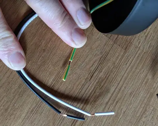

I recently bought a new light fitting off amazon.co.uk which has come with wiring as shown in the picture:
Wiring of light
I'm surprised to see black/white cabling since I thought this to be the US colour coding. The listing on Amazon claims
Compatible with world wide voltage - 110V or 240V and everything in between - please make use appropriate voltage of light bulb

The wires
If you find a proper UL listing or equivalent, then you can install it. Due to treaties, a CSA listing on a US product is honored in the EU. (again CE isn't anything, but a TUV listing from a German product is honored in the US). So it's not uncommon to find EU color codes (brown/blue) in the US or US color codes (black/white) in the EU.
Black is hot and should be taped brown (not critical).
White is neutral and should be taped light blue.
* They get "verified sale" on their reviews thusly: Initially they direct-ship the items, place hundreds of orders from sockpuppet accounts, don't actually ship the item, collect the payment from themselves (eating Amazon's cut), then write a glowing 5-star review of themselves. Then with their 4.7 star rating, they place it in Amazon Fulfillment so it's drop-shipped from an Amazon warehouse.
So green / yellow is earth.
You can put the black to live (aka phase) and the white to neutral (based on the comment by Dan D below). You could satisfy yourself by using a multimeter to check for continuity as appropriate.
If you are still unsure, then employ the services of a qualified electrician.

  • It is black to phase and white to neutral. Otherwise If it had an Edison base the threading would hot. – Dan D. May 14 '19 at 08:42
  • @DanD. I will edit, of course, if you put your finger inside the fitting then it is easy enough to touch both anyway, which is why the supply should be disconnected even when "just" changing a bulb. – Solar Mike May 14 '19 at 08:43
  • @SolarMike it’s more important than “finger in the socket”. If polarity is reversed the threads of the bulb remain hot while the bulb is being unscrewed. It should just take half a turn to disengage voltage when changing a bulb. Ever had a bulb break during changing process, halfway unscrewed? – Tyson May 14 '19 at 13:26
  • @Tyson you should disconnect the supply - and suggesting otherwise is not good practice... And I have had many bulbs break - but never had any cut from that happening... – Solar Mike May 14 '19 at 13:27
  • @SolarMike while I usually do personally, I can’t rely on “anybody” that might change the lightbulb doing so. This is one of many reasons polarity must be correct for an Edison socket. – Tyson May 14 '19 at 13:32
  • @Tyson so "finger in the socket" was about disconnection of the supply. My answer has been edited so where am I stating it is wired incorrectly? – Solar Mike May 14 '19 at 13:36
Internal conductor coloring means nothing really, although you should probably stick to the earlier recommendations; i.e. white to neutral. As to 240V or 120V, that boils down to the bulb you install, meaning that if you use a 240V rated bulb, it's 240V. The device itself (socket, switch if any) will all be "300V class" meaning clearances and insulation is good for anything up to 300VAC.
