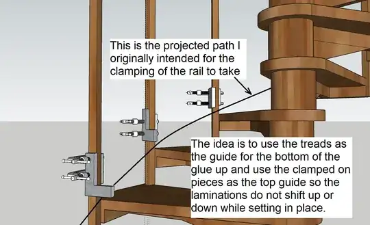

This is a jig I made to line up the bent rail for marking the locations for the mortises on the bottom, and for marking the angles you will ned to cut your balusters. How you cut them will depend on how you choose to fix it in place. There are a few options here.

I added a few sketches to illustrate. A conversation would really aid in focusing in on the details needed instead of trying to cover different scenarios. There is another way that may be easier – Jack Jun 02 '19 at 15:57
