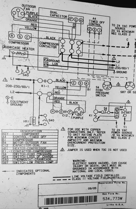

wiring diagram from inside the unit,  ref. C12

  • Look up a wiring diagram (or other documentation) to find the original values. – Tyson May 28 '19 at 00:55
  • I checked the wiring diagram inside the unit. All it has is a label "C-12 CAPACITOR - DUAL". Checking several parts sources online, I found a number of different caps referenced for this model, ranging 300 to 500 volts, 5/30 uf to 7.5/60 uf. – Eric Simpson May 28 '19 at 03:34
  • @Tyson, I extended my online search but only found the same diagram, an installation guide, and a 2 page marketing flyer, nothing with specs on the cap or compressor. Do you have access to more helpful info? The original cap lasted 7 years, this one lasted 4. How long would you expect a cap to last? – Eric Simpson May 28 '19 at 11:31
