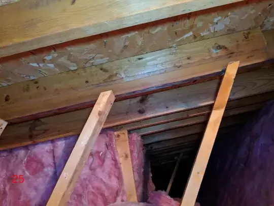

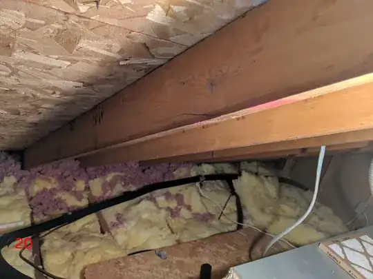

There are a couple rafters, at least that I can see, that have been repaired, and a couple other cracked ones. I think one is getting worse, or at least worse than when I had the house inspected.

enter image description here enter image description here Pictures 24 and 25 are a couple of the repaired rafters.

The rafters look fine. They are straight, showing no signs of sagging or stress. The cracks that you point out are the usual lumber "checks" that appear as the wood dries. The checks have little structural impact and are accounted for by architects and material specifiers.

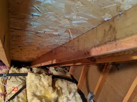

The attic that was finished may not have large enough or close enough joists to support heavy loads or walking (e.g. 2x4 on 24" center), letting them flex and crack the ceiling below. This spacing may also be repeated in the rafters. Another sign the rafters may be built to a bare minimum spec is your mention of "There are a couple rafters, at least that I can see, that have been repaired, and a couple other cracked ones. I think one is getting worse, or at least worse than when I had the house inspected."
If the rafters are on 24" centers and the attic was finished by simply nailing 2x4's between them to make the attic ceiling and knee walls (see the angled edge in pic 13), then wind, furniture, and live loads (e.g. walking in the attic) could flex the drywall up there enough to cause cracks as seen in pics 1, 2, 3, 5, 6, 10, 11, 13, 16, and maybe 19. It could also contribute to cracks around the skylights, like pic 9.

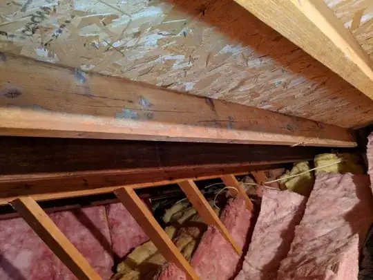

    I posted some pics of the rafters. I'm not sure if the stairs have sunk any since I moved in. I didn't measure or take note. I added to the comment on pic 14. When I had the house inspected they said the deck was cantilevered to the house. And that to make the deck to code it should be free standing. – Jerinaw Jun 02 '19 at 02:25
