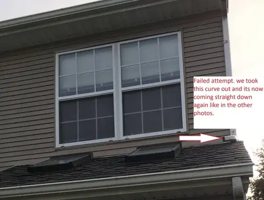

I have an upper roof downspout emptying onto a lower roof. the downspout exit sits near the side of the lower roof, and water falls off the side before continuing down to fall into the lower roof gutter.
is it possible to install a gutter along the side? is the only solution a downspout extension to the lower gutter? how is the downspout extension secured? We prefer the gutter along the side but can it be attached to the existing lower roof gutter? not sure what type of gutter corner that would require. i don't think we can send the upper roof downspout straight down to the ground due to association rules.
we have two skylights so we can't move the upper roof downspout towards the center of the roof because of how much water is directed out from the upper roof. We want to avoid a leak in the Skylights.
this roof is only about 10-12 feet long[![][2]]3

We have a similar two story house where we had contractors redo the gutters. They continued the downspout from the second floor over the roof of the first floor and positioned it directly into the hole in the first floor gutter.
No straps were visible on the run over the first floor and it appears to be secured at the second floor downspout only.

  • I think piping that water from the upper spout to the lower gutter is the ideal solution. If the roof is in a place where leaves or pine needles are prone to collecting, consider whether to elevate the downspout pipe above the singles so that debris won't collect under or around it (collected debris could cause accelerated deterioration of the shingles). – Greg Hill May 31 '19 at 19:10
