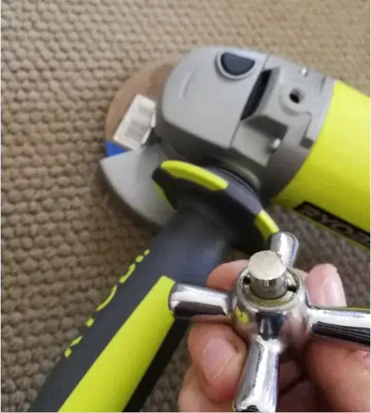

Wasn't having much luck with ours so I ended up cutting the tap handle off using an angle grinder. We were then able take the bonnet off and replace the tap with a standard one to avoid this issue in future!
A plumber quoted us hundreds of dollars to replace the taps (assuming he could get the tap handles off).
If you already have a hacksaw/grinder this might be the way to go.
