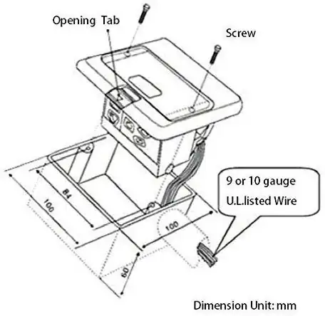

I purchased a 220 V outlet and didn't realize it. My circuit is 15 amperes. I wanted to hook up a series of normal 15 ampere 110 V outlets. When I look at the outlet it looks exactly like a regular 15 ampere 110 V one?...but it has a red, blue, and yellow wire instead of black, white and green wires.
The red wire connects to the brass screw (where black normally goes), the blue wire to the silver screw (where white normally goes), and the yellow to ground (where green or brass wire normally goes). The instructions are in German and/or English.
It looks like the outlet is just a metal backing and a plastic face. It should be ok to hook up these outlets and use them as 110 V ones, correct???
Is there anything special about the way a 220 V or 110 V are made?
I am in the US, near Washington, D.C
image source: amazon.com
Pop-up floor receptacle diagram of receptacle with installation measurements
frontview of pop-up receptacle underside of pop-up receptacle with incorrectly labelled instructions

    Uh, that's not a 240V outlet, can you post actual pictures of the device you have? – ThreePhaseEel Jun 09 '19 at 23:06
    This is the outlet I purchased. ... https://www.amazon.com/gp/aw/d/B07CQRVC3M?psc=1&ref=ppx_pop_mob_b_asin_title – Steve Jun 09 '19 at 23:06
    It says it is a 15 amp outlet but the paperwork says 220v - 250v – Steve Jun 09 '19 at 23:09
    Is there a label on the pop-up-receptacle itself that you can post a photo of? Something with a model number on it or the likes? – ThreePhaseEel Jun 09 '19 at 23:24
    No, don't see a label. The only thing I have is what is on the Amazon page and what the picture shows. The box is striped blue and white with no manufacturer name or anything descriptive at all. The pamphlet is worthless. It only shows how to hook the receptacle into a box. No wiring instructions at all. The photo has a cover page with a model number and 220v - 250v on it. – Steve Jun 09 '19 at 23:57
    If anything that label probably means it's "rated" for that voltage, but it could even be a typo. There's not much of a difference between a 120v outlet and a 240v outlet, but I do agree that you might not want to trust a company that can't get something simple like that correct. – JPhi1618 Jun 10 '19 at 15:08
    These could have been manufactured in the Philippines,where they actually put 220 on US 120V receptacles. – Doug Jun 11 '19 at 10:16

Send it back and get something that's listed for the job
While what you have is indeed a 120V outlet (the outlet configuration governs, not some text in a manual somewhere), this outlet is not usable in a countertop or work surface in the USA, as it is not listed or labeled for use in a countertop or work surface, as requred by NEC 406.5(E) through (G):
(E) Receptacles in Countertops. Receptacle assemblies for installation in countertop surfaces shall be listed for countertop applications. Where receptacle assemblies for countertop applications are required to provide ground-fault circuit-interrupter protection for personnel in accordance with 210.8, such assemblies shall be permitted to be listed as GFCI receptacle assemblies for countertop applications.
(F) Receptacles in Work Surfaces. Receptacle assemblies and GFCI receptacle assemblies listed for work surface or countertop applications shall be permitted to be installed in work surfaces.
(G) Receptacle Orientation. Receptacles shall not be installed in a face-up position in or on countertop surfaces or work surfaces unless listed for countertop or work surface applications.
So, you'll need to return it and get something else that has an actual UL/ETL/... listing for this application.
