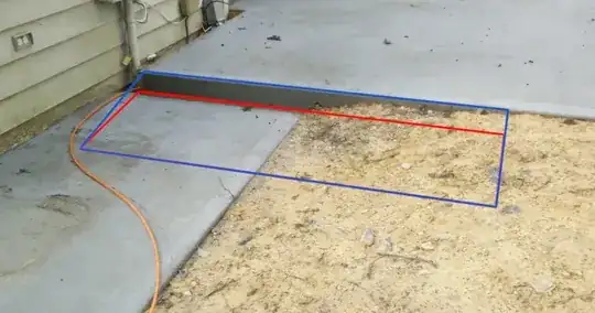

Here is a (bad) drawing of the proposed ramp: proposed rampIt would be straight on the left matching the lower pad, I'm just bad at Photoshop. The ramp will be 2 feet by 8-10, and will rise to 6 inches high to meet the higher level.
They say "We will cut and remove the lower portion out of the trash can pad so we can pour solid 4" down so we are not going to zero on top of the existing. The area on the sides will have rebar to tie the two together. This is standard practice."
Is that OK, or should I insist on tearing out the lower slab and redoing it with the ramp as part of the same pour?

They are taking out the lower area to have a full 4” pour, they are tying them together with rebar so I don’t see any issues, for foot traffic in a small area 2” even works. I see driveways poured at 4” all the time so I think they are planning a proper fix as long as you are happy with there design.
  • thanks. I have given the company the go-ahead. I believe SE etiquette is to wait 24 hours before accepting, but will do so later tonight. – edgewood Jun 11 '19 at 21:29
