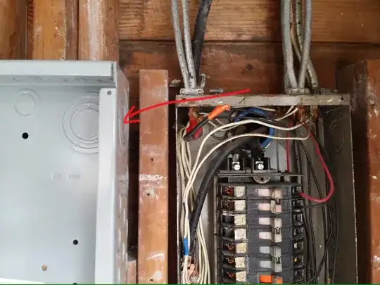

How do I have to run the SER cables from the original hole(where the SER cable goes through the wall) to the side of the new panel?
Can SER cable be exposed or needs to be inside a conduit? Conduit type? AFAIK I can not use EMT, the city inspector says that, and she is not very friendly on providing such information.

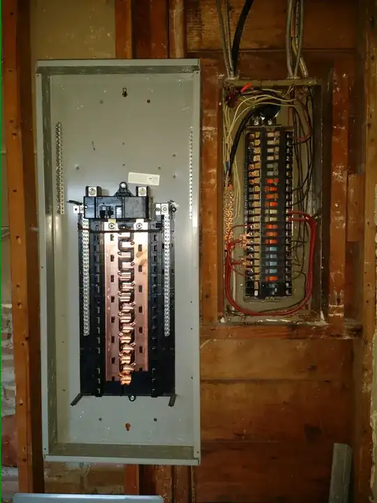

Edit/Update: Here is the entire picture of old and new panel enter image description here

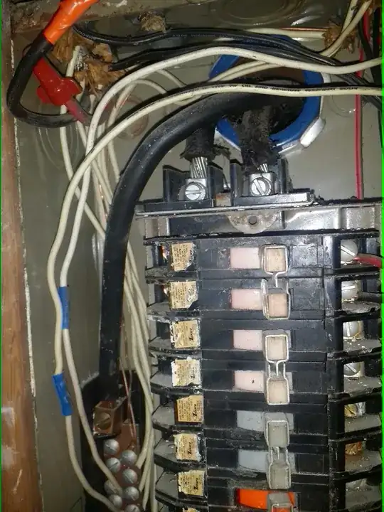

EDIT about Service cable entrance enter image description here

  • Is this panel going to be surface mounted at the end of the day? It sure looks like it... – ThreePhaseEel Jun 13 '19 at 02:26
    Also, where does the white wire that enters via the bottom left of the old panel go to? – ThreePhaseEel Jun 13 '19 at 03:13
  • @ThreePhaseEel I will frame it around, no surface mount. The inspector does not allow me to have exposed wires. Running Romex cables out of it I don't think you can run them in conduit. The white cable on the bottom it is the ground. – cadobe Jun 13 '19 at 14:40
  • It's legal to run Romex in conduit... it's just really hard. Also there are draconian and seemingly unfair rules about the number of Romex per conduit, they involve complex calculations, and a newbie *will* inadvertently violate code, get written up and have to redo. I just tore out a case of two 12/2 Romex in a 3/4” conduit, 8’ long and with a 90 degree bend in it no less. Guy who pulled that off must have felt like a hero. Totally illegal. – Harper - Reinstate Monica Jun 13 '19 at 16:02

  • @cadobe -- how wide/deep is the original box? I have a suspicion that the "cripple wall" Harper mentioned might not be that at all, but framing around a box that was narrower than the stud bay it went into.... – ThreePhaseEel Jun 13 '19 at 22:27
I see where there is a cripple wall or something preventing you from fitting the new taller panel where the Zinsco had been.
Well first, I would go back to the drawing board and see if I could find a panel that fits inside the space the old Zinsco is coming out of. However your first priority is a whole lot of spaces, so I would only bother looking at CH or QO, since they put 40 spaces where other panels only put 30. In this day and age, you want 40.
If you just can't find a 40 that fits there at sane price, then continue with your original plan.
I presume you've considered laying a piece of plywood atop the pictured joists where the Zinsco was, with the new panel's entry hole lined up perfect with the conduit nipple, and extending the nipple as needed. I can see where that would create an access problem for one conduit entry at the bottom. Okay.
I consider the idea of using exposed flexible cable to be beneath discussion. It is on the wrong side of the main breaker, if it got hit with something, nothing would stop the arc fire. The bend would be freakish and very, very hard. You need XHHW single conductors just to make this DIY doable, and that needs conduit.
But that's no big.
Oh? She doesn't want EMT? Alrighty then... use RIGID. Realistically, you will need a conduit body to turn that corner anyway. That leaves only about 3 inches to go with actual conduit. Rigid is pricey stuff, but that doesn't matter for 3 inches.
When you tear out that ZINSCO panel, there will be a "pipe nut" that you unwind with a hammer and screwdriver. Once the panel is out, underneath that is probably a Rigid pipe nipple (a nipple is a short pipe) with pipe threads. Test fit the conduit body and see how much distance you need. You either replace that nipple with a longer one, or add a coupler and a short nipple to reach the conduit body, depending on what is practicable.
With Rigid conduit, you go to a competent hardware store who cuts and threads pipe (and shoplifters), and buy the right length and have them thread it.
Now, the only other risk is that the conduit body is so wide that it forces the new panel to the left. Could be. If that knocks it off the joists, get a sheet of 3/4” plywood about 33.5" (or wide enough to span 3 joists and 2 spaces) x the height of the new panel + 6”.
Then, you will need to account for the thickness of the plywood in the above nipple. So test fit everything first!
Then, you use appropriate sized XHHW wire. If the price of copper wire gives you pause, use aluminum wire 2 sizes larger. All 100A+ terminals are designed for aluminum wire and have aluminum lugs.
Remember, this is a whole domicile service, so you get the 83% favorable derate from NEC 310.15B7.

  • Can you take a look to the last image on my question? What type of cables are those? The panel is Main panel. Why should I use SEU since SEU stands for "Service Entrance Underground Cable"? The panel is 200 Amps so I need to go with AL 4/0-4/0-4/0-2/0 right? – cadobe Jun 13 '19 at 20:40
  • Yes not .Ser if that is main panel..Or copper or alum. Wires if going through pipe or nipples. Wire cable not needed.. –  Jun 13 '19 at 20:43
  • They are single wires. Not a Seu cable going through a close nipple .The way you should do it. –  Jun 13 '19 at 20:55
