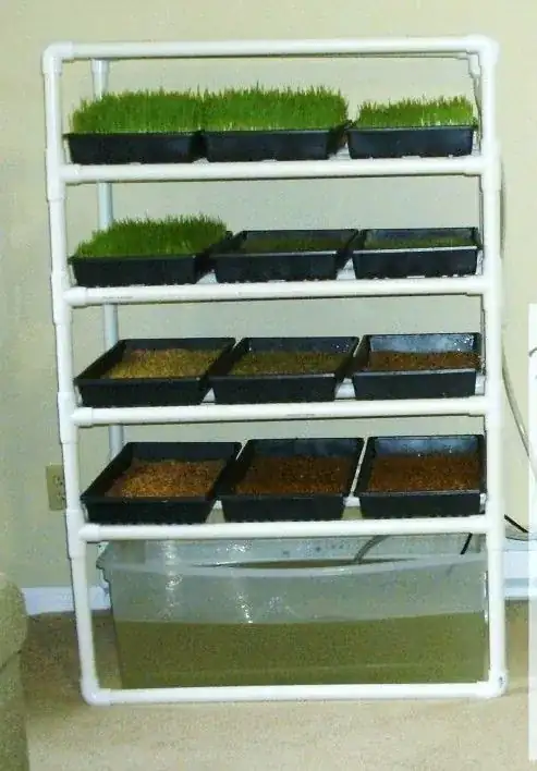

I want to circulate water which falls from a tank that 2.5 meters up to the reservoir tank at the ground level. I know there are numerous pumps but I want to use a washing machine drain motor if it is possible because it is cheaper than the other pumps. If I can please guide me - how I can soak water from the reservoir? - is it possible to pump the water to 2-2.5 meters high? - if I can't why?
Thanks in advance for your kind answers.
Edit: The title has aquarium to create right imagination for water pumps but I'll do fodder system like this: enter image description here
I need to raise water from the reservoir to the top of the shelves. I know aquarium motors will be usefull and cheap but I found washing machine motor 3 times cheaper.
