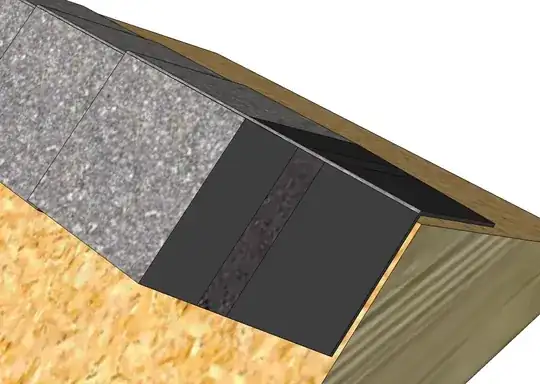

I've installed the ridge cap, using modified 3 tab shingles.
I've installed the ridge cap all the way to the other end of the ridge, but I'm not quite sure what to do now.
The next shingle will be hanging out over nothingness, how can I nail it down?
Please don't nitpick about not using Ridge Cap Shingles, that's a different question altogether.
That's what I've done in similar situations. Cut off the top half of the shingle (using the piece without the glue line) and 2-4 nails right through your last shingle. Cover the nails with a drop of roof cement.

Nail down, through the tar strip the dark grey shingle in your image.
Cut a new piece in half, throwing out the half with the tar strip.
Glue down the cut shingle with roofing cement. Remember to cover the nail heads from the last step.
I believe you can buy roofing cement in a caulking tube if you don't happen to have any left over.
