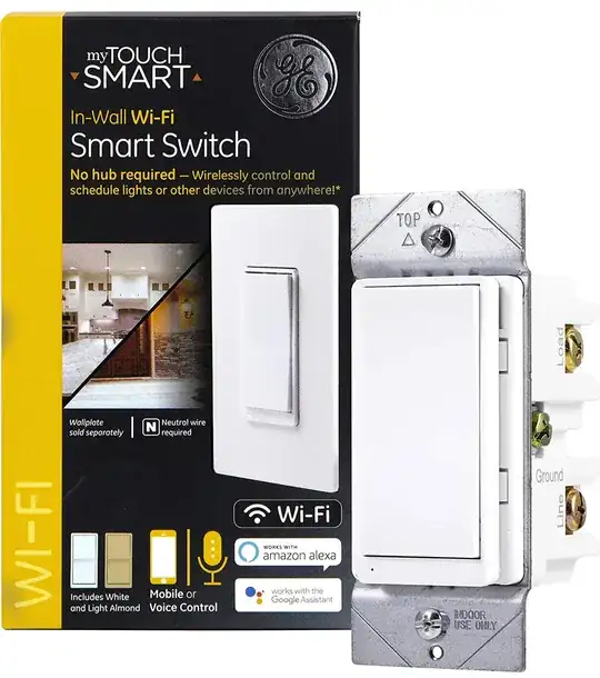

Option 2: Smart Light Switch
Here, you have more options from all the usual suspects (Lutron, GE, etc). Note that you'll still want to look for a UL listing. Replace the junction box your GFCI is in with a 2-gang one, and add a smart switch next to the GFCI. Wire the line side of the smart switch to the load side of the GFCI, and the load side of the smart switch to the UF cable feeding your outdoor outlet. An advantage of this setup is that you can manually operate the switch even if your wifi goes down.
GE Smart Switch
