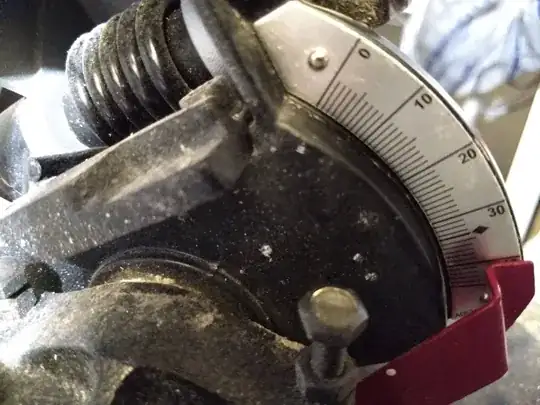

EDIT: Pictures of my saw enter image description here

    This is a compound miter shoot a picture of the saw yiu are using – Kris Jul 08 '19 at 02:20

  • @Kris I've uploaded a pic of my saw – Marinaio Jul 09 '19 at 14:01

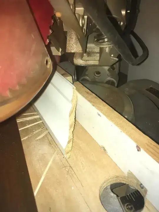

Mini sled... mine:
basic sled
(Not shown: the upright of the sled is bolted to the fence of the saw so it won't move. Clamps might be an option, but they'll probably get in the way.
Terrible picture angle, but set the crown upside down with the flats aligned with the base and the fence:
crown up against fence
Note the pencil line that indicates where the crown is supposed to sit on the base. Hole in the base so I can see my miter angles.
Finally, tack a straight bit of something onto the pencil line on the sled to keep the crown from slipping out of angle:
attach a stop to the base of the sled
Last notes, if you're meeting up to an existing piece, they may have felt forced to tweak the spring angle just a teensy bit, which will make it hard to match perfectly. Do as much as you can to have extra length while you're whittling away at a perfect fit. Don't expect corners to be perfect 90 degrees, either. If it's paint grade, there's a lot of forgiveness to be found in sandpaper and spackle.

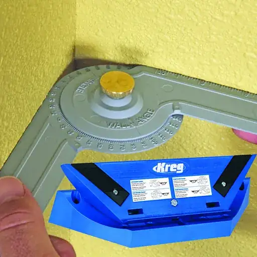

Thanks to everyone for the great ideas which led me to "my" solution.
I bought the Kreg Crown-Pro and although a great tool it lifts the molding to high and my saw can't make the complete cut.
Not saying it's bad, just didn't work for me.
However, the Kreg directions (not the tool) were the key for me.
I carefully clamped the molding to the saw upside down. I used the Kreg methodology to find the angle to cut.
It came out better than I thought.
