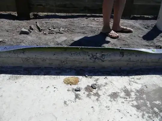

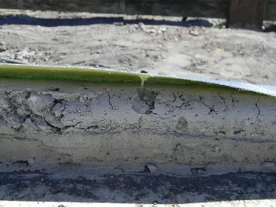

Missing chunks of concrete: Missing a small chunk of concrete Another missing chunk of concrete

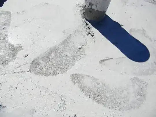

Footprints in shower recess concrete: Footprints in shower recess concrete

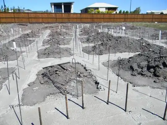

Edit - Here's a shot of what was in place immediately before the slab went down:

  • @UNECS - Negative on the expansion joints. They did use steel riobar, yes. And I'm not positive but I believe they did use chairs to hold the steel in place. What they did was before pouring the actual slab they excavated a network of trenches and filled that with concrete, and then had steel bars protruding vertically out from that at regular intervals (I'll add a picture of this). My assumption is that they used those vertical bars to secure the riobar in place, though I wasn't onsite at the time to see if that's what they actually did. – aroth Sep 08 '12 at 12:22

Regarding footprints, it is tacky. However, the roughness can actually help the concrete and thinset to bind unless it is flaking.

  • I agree almost all concrete cracks at some point but the rebar provides strength. The small chunks that broke out When the form boards were pulled is not unusual, we usually oil our forms to reduce this and either vibrate or smack the forms with a hammer to reduce air voids. Not a very attractive pour but I have seen much worse from "profesionals". – Ed Beal Dec 29 '17 at 19:49

  • I don't think I agree with the two much water the side shot in 1 photo shows a very dry area. Trucks regularly add water when the mix is getting stiff. The only way to know is if cores were pulled for compression testing. I do this on foundation work especially when pumping. – Ed Beal Dec 29 '17 at 19:51
