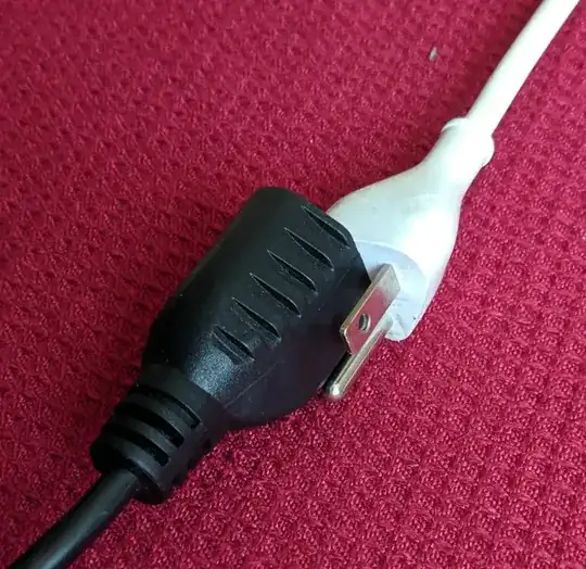

I think I’ve found a potential design flaw in an extension cord. It allows you to plug in the hot blade, while leaving the neutral blade out and exposed. Obviously you shouldn’t try and use the cord like this, but is this actually safe, as in you won’t get a shock from touching the exposed pins?
It seems like I could complete a circuit to ground by touching the exposed neutral blade, which obviously I don't think would be great for my health.
I'm in Canada, the outlet it's plugged into is wired correctly, and there's no GFCI on the circuit.
plug (female view) plug (male view)

No. In this condition, the exposed plug blade will be deadly.
Every load connects hot to neutral. It does so through some level of impedance, but that impedance is not enough to protect you from shock.
If you have a GFCI/RCD device somewhere protecting this load, that will intervene to prevent injury in this case.
One detail: Current wants to return to source, not ground. For man-made mains current, source is the supply transformer, and hot power is seeking neutral. It will be happy with ground, because back in the main service panel there is a neutral-ground equipotential bond connecting them, so it will go via ground to get back to neutral.

This is absolutely NOT safe. There is actually a part of the NEC to help with this type of problem - tamper resistant receptacles. That doesn't address exactly the same situation - extension cords are functionally the same as receptacles but practically speaking a bit different and don't normally (ever?) have tamper resistant sockets. But a tamper resistant receptacle prevents you from inserting only hot or neutral - you have to insert them both at the same time.
    Actually, a tamper resistant receptacle prevents you from inserting any part of the plug at all - that's why they are so safe :) – Michael J. Jul 30 '19 at 21:42
You might also notice that you have plugged the hot blade into the return socket! Whatever were you thinking? The reason that "blob" of material is part of the black receptacle is to ensure that you plug in "right side up" , with the ground pin in the ground receptacle.
Don't be a Darwin Award candidate.
