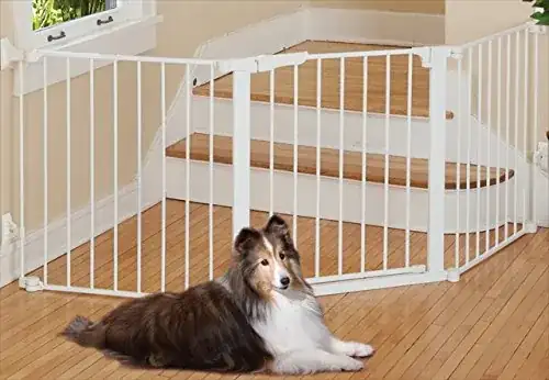

They make a variety of gates for just this kind of thing. They typically have 3 segments with adjustable angles.
For example at Amazon:
Flexible gate
That middle segment is the normal gate, but the whole thing can swing/fold if needed.

  • The problem with this is that it'll jut out awkwardly into the hallway for this situation unless one panel can be shortened. It's not a drop-in fix. – isherwood Aug 02 '19 at 14:05
    @isherwood, every one of these, that I've seen, allows you to detach panels if so desired. People have been refining these readily available designs for decades now. No need to try to reinvent the wheel. – Brock Adams Aug 02 '19 at 14:34
  • How does detaching panels help here? We have a 4" leg and a stairwell leg of around 42". What configuration do you suggest that covers the stairwell without jutting out into the traffic flow? You either have to cut across the stairwell drop or shoot out the opposite way. Your answer is basically "buy a gate that fits", which doesn't help. – isherwood Aug 02 '19 at 14:35
