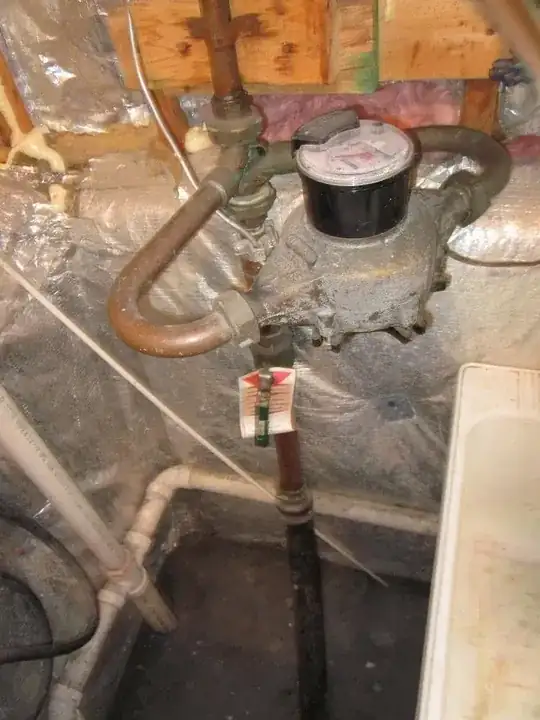

I bought a whole house water filter to hook up to the main water line. The plumber who came in said that he won't be able to install it because the pipe that comes from the ground hooked up to the copper pipe is plastic.
He says that this plastic is usually not used for that kind of water pressure for the main line and can burst at any time. If he starts cutting the pipe above it to hook up the water filter, there is a potential that the plastic could break/leak due to all the shaking etc. He has asked me to contact the builder/home inspector (as it shouldn't have passed the home inspection like that? ) and take care of this first.
Picture is below. The black color pipe is the one in question. Has anyone seen plastic pipes come up from the ground like that to the main line? Will it burst?

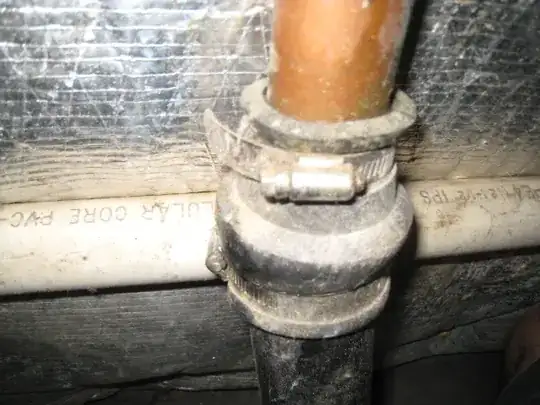

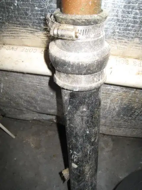

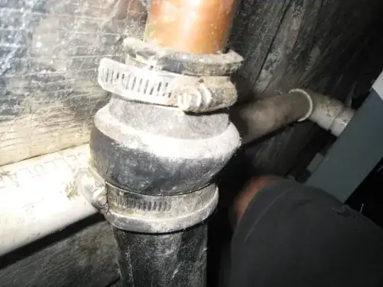

Close up pictures on request. I looked the pipe closely. It is written 1 1/2" 0.1 / Plastic. (above the first ring at the bottom, you can see it in the second pic). House is built in 1993.

  • Did you read this "*1 1/2" 0.1 / Plastic*" off the coupling (the black piece that joins the two pipes), or the black pipe itself? – Tester101 Sep 14 '12 at 11:48
  • ok, I read it on the coupling then, I couldn't see anything on the pipe itself. I'll try one more time today to check the pipe in detail. – coder net Sep 14 '12 at 16:49

Though it may seem odd, it is possible the plumber knows what he's talking about. If this is a Polybutylene pipe, it could indeed be brittle and fail if it's jostled during the installation of the filter.
It's impossible to tell from the picture what type of pipe that is, but based on the plumbers concern I'd guess it is Polybutylene.
Polybutylene
Polybutylene was used in pipes between about 1980-1994/5, and was commonly used as supply line in the 80's. It was found (in some cases) to react with oxidants in the water supply, which caused the pipe to become brittle and fail. To my knowledge, this type of piping is no longer used. Though if the house was built; or there was supply line work done, during the 80's, it's likely this is Polybutylene pipe.

How can I tell what it is?
The only way to be sure what type of pipe this is, is to look for markings on the pipe itself. Polybutylene will be marked PB####, Polyethylene will be marked PE####, Cross-linked polyethylene will be marked PEX-x (where x = A, B, or C).
    Now this is a valid point - IF it's Polybutylene, you should immediately invest in replacing the water main, before the line breaks, because its only a matter of time. (Voice of experience talking here) – The Evil Greebo Sep 13 '12 at 12:23
  • @Tester101, it is marked as Cresline HD100 PE 3408. Based on your feedback, I guess it is safe? so whatever shaking/disturbance is done on the upper part for filter installation won't affect this pipe? – coder net Sep 16 '12 at 12:54
    @codernet I'm not a fan of the rubber coupling on a pressure line, but aside from that the pipe itself *should* be alright. Copper is cut using a [pipe cutter](http://www.photo-dictionary.com/photofiles/list/3900/5237pipe_cutter.jpg), so unless you have to pull the pipe away from a wall (or other obstacle) to cut it, there shouldn't be too much vibration involved. – Tester101 Sep 17 '12 at 12:03
Isn't that your water meter on the inside of your house, that the black city line feeds?
Shouldn't the whole house water filter be going AFTER the water meter?
In which case the black pipe is irrelevant, is it not?
Which leads me to think - you need a different plumber.

    Furthermore - looking at the picture more closely, the water meter is connected using a compression fitting, so all your plumber needs to do to install the whole house filter safely is shut off the main, disconnect the compression fitting by unscrewing it, then he can remove the copper from the wall by removing the mounting braces with almost no vibrations at all - and after the pipe is free of the wall he can use a tubing cutter to cut the pipe wherever he needs without shaking it as well... – The Evil Greebo Sep 13 '12 at 00:24
    Sounds like a plumber who did t want to put a filter in to me... Lol – UNECS Sep 13 '12 at 00:28
  • he may be afraid of the weight of the meter snaping the pipe and or bumping it etc. – Kendrick Sep 13 '12 at 02:50
  • @Kendrick The meter connects on both ends - the same way too - simple solution there would be disconnect the intake line first. – The Evil Greebo Sep 13 '12 at 12:25
  • What he said is that if he cuts the copper pipe above, it may shake this plastic, and he just does not want to cause any probable damage and cause a leak later. He said he can do it but its not advisable for me. – coder net Sep 14 '12 at 01:01
  • which is the compression fitting? – coder net Sep 14 '12 at 01:01
  • The two oversized connections at the end of the curved pipes at the water meter. They each are made up of two halves that screw together with a gasket in the middle. – The Evil Greebo Sep 14 '12 at 02:39
