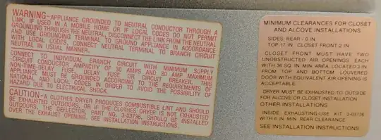

I purchased an old electric dryer to hold me over until I can have a gas line installed in my laundry room and am in the process of converting it from a 3-prong to a 4-prong plug. According to the warning the ground and neutral should be bonded. The problem is that there doesn't seem to be a white grounding wire. What do I do with the ground to wire this thing up safely?
According to this answer there should some kind of jumper. What does that look like? There is conflicting information in this answer. Is it safe to bind the neutral and ground wires?
Warning Current 3-prong Wiring
