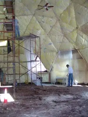

This is NOT how you install it: enter image description here
Note how its all compressed and tucked in? That kills the insulation value (R-value). I've heard/seen it argued that you should tuck the backing in so that drywallers can glue the drywall to the framing - they use screws. I've never heard of drywallers doing this - and I don't think its worth surrendering the R-Value for drywall glue... Plus if they really do want to glue, well you install furring strips (as they did in the above pic) and glue to those...

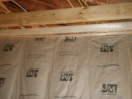

IMO THIS is how you install paper backed fiberglass:
Flaps folded over the studs, and stapled down. (Then tape the seams for extra measure as well as taping any tears). I still also don't trust paper as a vapor barrier, though often times its paper/plastic laminate in which case it'll probably be fine.
