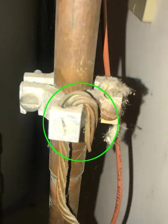

Slight side note, I'm also slightly confused at what looks to be a ground wire going from the green circle in the above image to the blue circle in the above image. This seems unnecessary and / or abnormal, but I'm not too familiar with how any of this would be set up "properly". Here are some close ups: Bottom Right Wire Top Left Wire

The copper wire is part of our house's grounding. It jumps around the meter and ensures that there is an electrically secure path "through" the meter. Because of the union joints and that some meter bodies are not electrically conductive, it provides a secure path. Also when the meter is being replaced.

  • Worth noting that depending on the materials of the meter, any electrical conductivity between it and the pipework is broken on purpose to prevent galvanic corrosion. – JMac Aug 14 '19 at 13:06

The wire attached is a grounding conductor which more than likely goes inside your breaker box .
