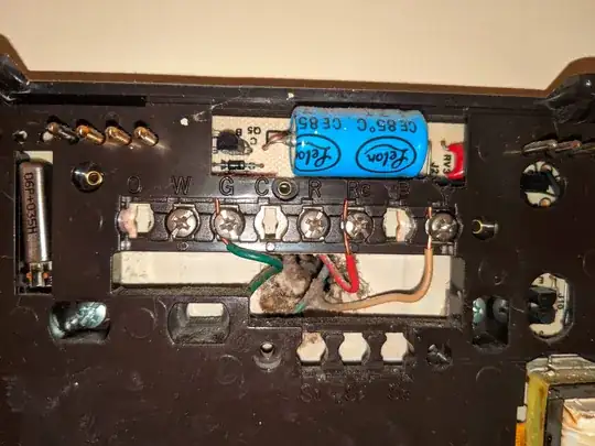

Can you please take a look at the below images and let me know if this will be as simple as getting both cables to the same location (haven't discussed with my other half whether this new thermostat will be up, or downstairs) and hooking up control wires as the instructions state, using the wire attached to the R terminal in the thermostat set for heating for R, and cap the wire attached to the Rc terminal in the thermostat set for cooling (or vice versa)?
Below is the wiring to one of our thermostats (Set for heating): Heating thermostat
Below is the wiring to the other thermostat (Set for cooling): Cooling thermostat

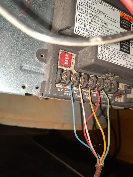

Below is the wiring block for the furnace: Wiring for furnace

Your system only has 1 transformer, at the furnace
Given what we know (that the cable with the red wire back-wrapped at the junction point goes off to the outdoor unit), we can tell that the orange wire from that cable is tied into the Y connection (orange wire) from the cooling thermostat and the Y connection (yellow wire) to the furnace as well.
This means that the other (black?) wire from the cable to the outdoor unit must be connected to C for this to work in a one-transformer configuration, and indeed, it connects to the blue C wire going off to the furnace. Furthermore, the red R wire from the furnace goes out to the red wires in both thermostat cables, which is also a sign you have a one-transformer system.
