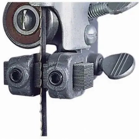

Check your lower blade guide. Blade guides are either blocks or small roller bearings. To be out that much, I suspect that someone didn't reset the guide after the last blade change, or perhaps the block has fallen out.
