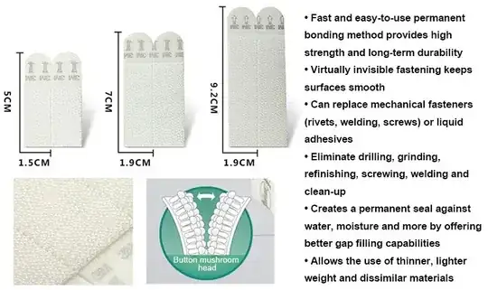

If the mirror doesn't weigh much more than 15 pounds, you could use some Command picture hanging strips (such as these or these). They're easy to install and relatively inexpensive.

Mirrors are often mounted simply using double-sided adhesive tape. Just google "adhesive tape mirror", and you'll find a lot of products from all brands. You'll find those in your local depot, too.
Just be aware that there are two kind of double-sided tape: one that is very thin, and one that is thicker (~2mm), with a core made of foam. If the wall surface isn't perfectly smooth (e.g. a drywall painted with a roller typically isn't smooth enough), you need to use the foam type.
Also, be aware that, if you ever plan to remove the mirror, the tape may be strong enough that you can't just unstick it without risking breaking it.

    command velcro strips may be a solution if you want to be able to remove it. – Jasen Sep 18 '19 at 08:26
