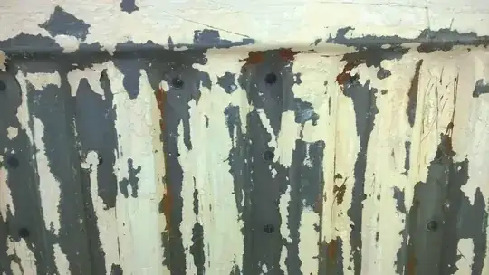

Questions: As it turns out several of the joists are not sitting flush with the beam and have as much as a 1/2" gap at the top and 1/4" gap at the bottom between end of joist and steel beam.
We checked again with Simpson - they advised that they have test results with short cut joists for LUS hangers but not with LRU ones. They checked the test results and advised that even with the bottom two nails not really going into the header and short cut joists the LUS hangers would be fine when installed with SD9x2 ½ (SD9212) screws (as long as they are not cut of course). They are unable to comment on the LRU hangers as they don't have test results with short cut joists. To sum it up they recommend using the LUS for that reason but say ultimately it's the engineer's decision.
It is not clear if our engineer was aware of the short cut joists when he ok'd using LRU hangers and we are now very concerned about using LRU hangers given the feedback from Simpson.
Please note that only a couple of joists (shown in picture) are sistered so aware that a different hanger is needed for those. Picture is meant to show gap between joist and beam.
We would greatly appreciate any feedback based on the above. Thx
(edited for clarity) First image is view from directly below the beam and looking up. You can see the gap between bottom of double joists and beam...the gap is more like 1/2" at the top of the joist.
enter image description hereenter image description hereenter image description hereenter image description hereenter image description here

  • I would be more concerned with the width over the length, 1/4” in my framing days would have been excessive but the width it should be shimmed. Not much you can do about being short. Since it is an engineered job make sure the engineer is aware he had the contractor move them was that a mistake? – Ed Beal Sep 18 '19 at 13:25
  • Why didn't they just pocket them into the I-beam and 'block' them? ... Anyway, I'd drill a hole in that second-from-the-bottom part of the flange, the one above the nail that missed that has no holes, and call it a day. Our resident lumber guy says it's OK as is, so w/e. - Also, LOL at the nail they put there for show. – Mazura Sep 19 '19 at 02:56
  • I just noticed the part of the hanger they cut out. Yikes. I'd do *three* new holes in the lower section. – Mazura Sep 19 '19 at 03:08
  • Previous question: [Contractor cut joist hangers to make them fit](https://diy.stackexchange.com/questions/172829/contractor-cut-joist-hangers-to-make-them-fit). Note: there's two 1/2 pieces of plywood behind the 2x8 header that's inside the i-beam. – Mazura Sep 19 '19 at 03:12
I think the joists cut short are fine because, 1) required bearing is satisfactory, 2) withdrawal out of hanger is not of concern.

  • Thanks all for your feedback. We ended up using the LUS210Z hangers with screws as suggested by Simpson. The contractor used a different hanger for the double joists. Attached some pics of the finished work to the original post. – user105375 Sep 26 '19 at 10:45
