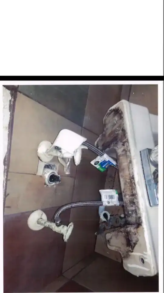

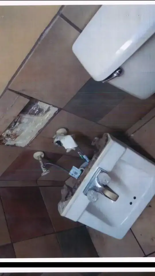

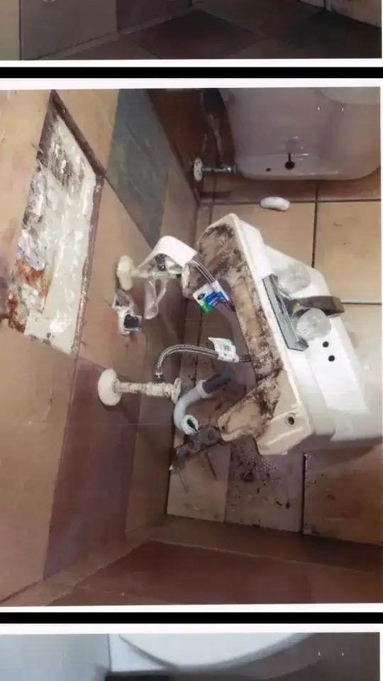

I went to the restroom before I was gonna eat at the restaurant after using the restroom I flushed and attended to the sink to wash my hands as I put just the pressure of my elbows on the sink to scoop a splash of water on my face the sink came off the wall hitting my knees pretty hard and my body shot backwards to the floor causing me to hit my head w hard on the tile floor not a good day! I tell ya so my question is what could cause a sink mount to fail (you can see the mount on the floor in pics)im only 130 pounds so I'm not a big guy.! Can anyone see anything wrong with these pictures at all????

You can see the angled mounting bracket hanging down under the sink. The bracket is what holds the sink firmly on the wall, the lower holes in the sink are for keeping the bottom of the sink from being pulled away and up from the wall once it is lowered down onto the bracket. The top holes have nothing to do with the mounting of the sink.
The bracket failed, probably because it was not screwed into structure ( studs ).
We can not see inside the wall to say exactly why the screws pulled out.
The bracket must be attached to studs or usually to a block that is run between the studs.
The bracket is essentially a french cleat, the back of the sink is cast so that is slips down onto the bracket. The bottom holes in the sink are just to secure the sink and keep it from being lifted up and off the bracket. Adhesive or caulk have nothing to do with keeping the sink on the wall. If some thought that was the case they were mistaken.
The bracket holds the weight of the sink.

  • I don't see any perforation of the drywall where that bracket would have been. I do so a spot higher on the wall where it looks like a screw pulled out. – Nate Sep 28 '19 at 16:53
  • @Nate I can not say how this sink was mounted, i do see part of the bracket with one bolt attached to it hanging off the under side. I am not saying hot THIS sink was attached, i am saying how it is **supposed to be attached**. – Alaska Man Sep 28 '19 at 19:58

You've got four holes through the sink for mounting: two large ones in the top corners and two smaller ones at the bottom. The wall where the sink was looks like it's got water damage so I'm guessing it was mounted to the wall with smaller bolts and washers than it should have been and with the water damage and your massive 130 pounds, it just succumbed to gravity. Hope you weren't hurt too bad. Did they comp your meal??

  • Do you see any large holes in the drywall? Even if the drywall was water damaged you'd expect the sink to be bolted to at least 1 stud. I sure wouldn't toggle bolt that thing to drywall. It doesn't look like they even bolted it. Pushing downwards on the sink, assuming there were bolts in there, would require the bolt to move horizontally through the drywall tearing large vertical gashes, it isn't like the weight was pulled directly with the direction of the bolt paths to create nice little holes the size of the bolt diameter. – Fresh Codemonger Sep 28 '19 at 02:25
  • Watching youtube videos of how to install the wall mount sinks they show blocking being inserted between the studs to fasten the sink to. I'd be surprised if a wall mounted sink instructions recommend a toggle bolt installation. I'd chalk this up to a bad installation of a wall mount sink. – Fresh Codemonger Sep 28 '19 at 02:51
  • I have a feeling there weren't any bolts installed at all, and the only thing holding that up was the construction adhesive. – user3757614 Sep 28 '19 at 06:55
  • not only the construction adhesive, the waste pipe was also holding it up. – Jasen Sep 28 '19 at 09:09
  • The top hole have nothing to do with the mounting of the sink, they are casting holes. The sink sits on an angled bracket, The bracket failed, probably because it was not screwed into structure ( studs ). The lower holes are for keeping the bottom of the sink from being pulled away from the wall keeping it from moving but they do not support the weight of the sink. – Alaska Man Sep 28 '19 at 15:42
  • Wall mounted sinks are not very sturdy in the first place and I see no evidence of the mounting, there should be a minimum of 2 larger lag bolts into the structure. The bottom ones don’t do much if there. If there were lags of the proper size into the structure I don’t see them toggle bolts even on backer board would not be a proper anchor.+ – Ed Beal Sep 28 '19 at 15:48

I only see one screwhole in the wall, which has rust colored stains around it and there's clearly mildew on the back of the sink. Looks like they may have also used construction adhesive on the back (or is that just silicone?) which is fine but not an acceptable alternative to mechanical anchors at multiple points.
Seems like it was poorly mounted to begin with, plus had some mild water damage.
