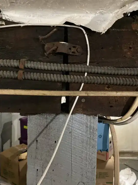

My house is 115 years old. The floors slope towards the center in every direction. I just discovered the main carrying beam is not continuous from the front of house to the back. The first is about 15' in length, the second is about 10' (I'm guessing). The 15' beam has a support column, then theres a second column that supports both beams where they meet.
There is a gap between the beams, about 1/2". Is this safe? Is this part of the cause of the sloping floors? Should it be replaced with one continuous beam?

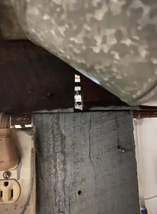

The gap between beams and column supporting them Reverse of the above
  • Are the two beams level?? Has the "center " support sunk at all? – JACK Oct 05 '19 at 22:07
    The photo appears to show that the gap between the ends is wider at the bottom than the top. This seems consistent with the idea that the support has sunk over time and that the floors all slope to the center. As far as the original question, however, there is nothing inherently unsafe about having the two ends meeting on top of the support post. – jwh20 Oct 05 '19 at 22:20

  • @jwh20 the slope is stronger evidence that the post may have sunk, the uneven gap only suggests that the ends were not cut perfectly square. – Jasen Oct 06 '19 at 02:23
  • @JACK (not sunk) are you suggesting that perhaps that the house was built with sloping floors? – Jasen Oct 06 '19 at 02:27
  • @Jasen No, just that the post may have sunk over time – JACK Oct 06 '19 at 10:47
  • my point is that it really doewn't matter if the beams are level or not, the builders making the floor can compensate for sloping beams by packing or planing the joists. what matters is that the floor is not level – Jasen Oct 07 '19 at 00:06
We’ve learned a lot about construction in the last 115 years since your house was built.
We use to just worry about holding everything “up”. Now we design for vertical loads and horizontal loads (seismic and wind loads). We also worry about the performance of the structural systems over time...including shrinkage of materials.
Your beam (and gap between the two beams) is fine, but you should consider: 1) adding steel connectors to tie the beams to the posts, and 2) anchoring the posts to the foundation, and 3) jacking the beam up, if the floor is so far out of level that it’s noticeable.
1) It’s important to tie all structural members together so that during a seismic event or wind storm they all stay together. I’d use something like this for the center post (and an “L” shape for the end conditions): https://www.strongtie.com/shapes_specialtystraps/tandl_productgroup_wcc/p/t-and-l
2) The posts need to be secured to the foundation too. I’d use something like a Simpson Retrofit Post Base, like this:
https://www.strongtie.com/resources/product-installers-guide/rpbz-installation
3) Jacking the floor system up runs the risk of cracking plaster, tweaking the doors so they don’t close properly, etc. If it’s not noticeable that the floors slope, I’d skip trying to make the floors perfectly level.
When the house was built, it was common to use “green” lumber. Your beam is large enough that over the years it shrunk significantly (I’d guess up to 1”) as the beam dried out. It’s now stabilized, so if it’s not a problem now, it won’t be in the future.

  • This is great info, thanks! The sloping is definitely noticeable on all three floors. – Christopher Meyers Oct 06 '19 at 19:49
  • I have a similar situation in my house -- except that the dip was built that way. The support for the centre of the beam is a 4 wheelbarrow blob of concrete. The beam is on cribbing on this blob. Currently the middle of my kitchen is 1.25" below the edges, but the tile lines on the backsplash are level. And the top of that wall (middle support wall for that part of the house) is level. So the dip was there before that wall was there. I started to try to jack it up at 1/8" a week, but after the second drywall crack decided just to live with it. – Sherwood Botsford Oct 07 '19 at 13:23
