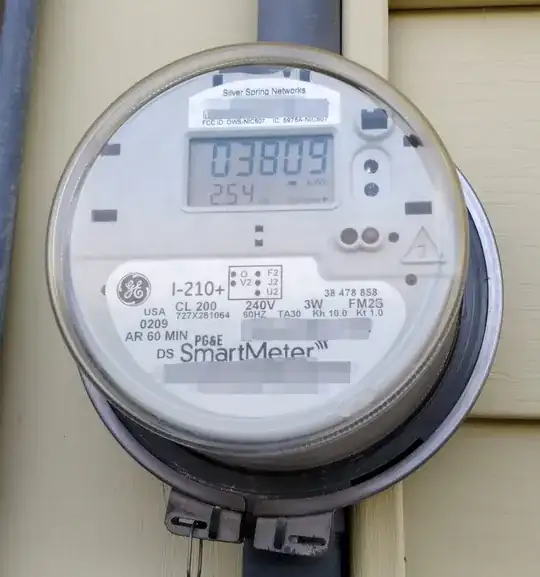

House Covered area: 1460 sq feet Meter photo: enter image description here

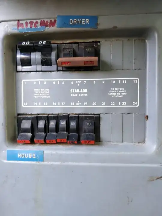

Main panel: The marking in Red deciphered as 'Kitchen' enter image description here

Subpanel 1 is old fuses. Small, but nothing inherently wrong with it (at least not without more details/examination).
Subpanel 2 is Square D - Good stuff.
Main panel is a Federal Pacific Stab-Lok firestarter
I am not a professional electrician (barely an amateur) but I have seen enough here on DIY and on other sites to know that is a BIG problem. See, for example:
Should all Federal Pacific panels be replaced?
In addition, even not being a professional, those breakers look nasty.
Replace as soon as you can afford to do so.
