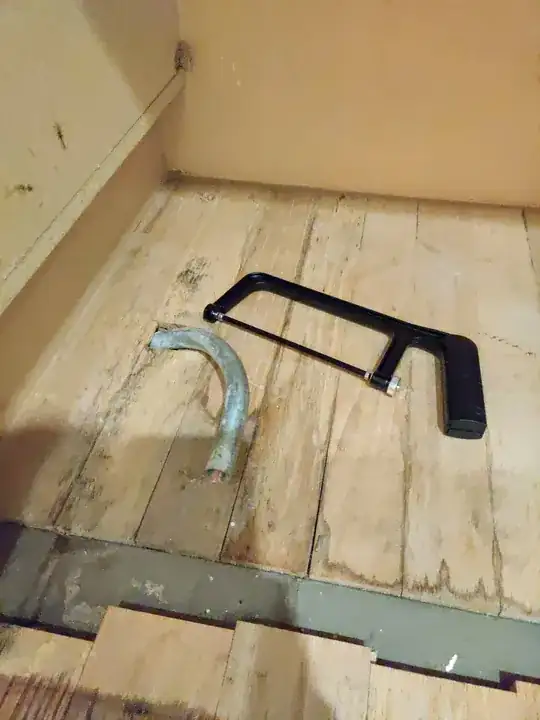

I need to remove this metal conduit or at least bring it even with the floor. I don't need to worry about preserving the wires inside the conduit. I only have a little hacksaw, but I'm open to buying other tools if needed. What's the best way to get rid of this conduit so that it's even with or below the floor?
2I’d use an angle grinder with a metal cutting disk – Kris Oct 08 '19 at 02:20
1Possible duplicate of [How can I cut a metal pipe while preserving the wires inside?](https://diy.stackexchange.com/questions/175773/how-can-i-cut-a-metal-pipe-while-preserving-the-wires-inside) – Solar Mike Oct 08 '19 at 02:37
1@SolarMike it's the same building site, but he's decided no to preserve the wires. – Jasen Oct 08 '19 at 02:46
I don't think this is a dup. – Harper - Reinstate Monica Oct 08 '19 at 03:23
1pull up the boards – jsotola Oct 08 '19 at 05:35
Grinder, failing that: a sawsall. But actually, that hack saw and then a hammer would do it. – Mazura Oct 08 '19 at 19:44

I'm assuming you don't have access to the backside of this conduit. If you did, you would just disassemble it - find the nearest coupler, uncouple it, and remove the pipe.
Remember to remove these orphan wires entirely; all the way back to the previous junction box (or past it, if they go past it). You're not supposed to leave orphan wires, though.

I can't seem to pull the wires out no matter how hard I pull, but I have confirmed there's no power going through them. Is that good enough? I don't know how I would remove the wires completely. – dfitzgerald Oct 08 '19 at 03:33
1@dfitzgerald You're pulling from the other box, right? You shouldn't pull from the pictured end. 2 wires shouldn't pull that hard out of 1/2" conduit, so if 10 pounds of pull doesn't do the job, there must be an intermediate box or conduit body somewhere. Again, Code requires it be accessible. – Harper - Reinstate Monica Oct 08 '19 at 03:42

Try a reciprocating saw with a blade designed for metal. Big brand name is Sawzall but all the major tool companies have them.
They are available both corded and battery powered.

maybe you can get the hackaw blade (without the handle) into the hole beside the pipe and then saw through it holding the blade in you hand, in locking pliers, or in a special blade handle.

Yep. Flex it tight to the floor. A rag around the handle end will prevent injury. – isherwood Oct 08 '19 at 14:46
A dremel with a metal cutting wheel will work.

Yeah, that's exactly what I'd do under the circumstances. – Harper - Reinstate Monica Oct 08 '19 at 03:23
4.5" angle grinder. Pick one up at harbor freight for $15. They are so cheap I just keep 3 around with different thickness discs attached instead of fumbling to change them. If one dies you have spares.
The other tools - oscillating/reciprocating/dremel generally are going to be more expensive, slower, and harder to get a flush cut. While I tend to buy cheap grinders I don't recommend cheaping out on the other tools.

1Interesting use of cheap tools. That said, don't use cheap discs. – Harper - Reinstate Monica Oct 08 '19 at 18:17
