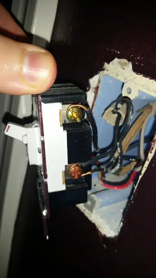

Here's a picture of the box, it is plastic and W: 3.75" H: 3.5":

Use an Arlington BE2
What you have appears to be a two gang plastic box, so you'll need a two gang plastic box extender such as the Arlington BE2 or equivalent (picture below is of a BE2, but for illustration only. These should be available at any supply house worth its chops, and can even be ordered from the orange borg if you can't get it any other way.
