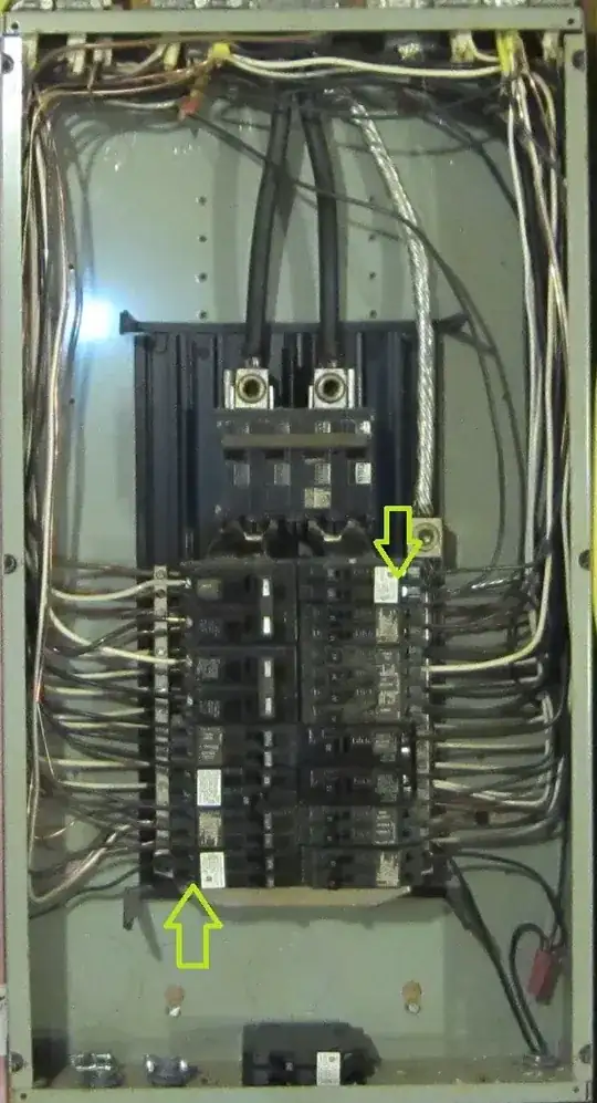

  • https://i.ibb.co/WPZtv1L/breaker.jpg – Steve Warton Nov 12 '19 at 00:58
  • I goofed. That 15 amp dedicated isn't dedicated. I just remembered. That would have been too easy. The arrows show the location of the two 20A I ran into the garage. Yeah, as far apart as possible! I guess what I could do is in the top left where there are two old-school large 240v breakers, is buy two smaller 240v breakers. Put the well pump (dual 20A) back into a newer, smaller dual, and then remove the bottom left 20A breaker, move the wire up top and use that with another new 20A dual 240v breaker. Hmmmm...Whatcha think? – Steve Warton Nov 12 '19 at 01:00
  • Yes, that could work, though note that you need 'quad' breakers for this. See here for more details: https://diy.stackexchange.com/questions/110151/what-is-a-tandem-breaker-aka-duplex-cheater-twin-double-stuff-etc/110152#110152 – Nate S. Nov 12 '19 at 01:04
  • Do you need GFCI breakers for this? If your location has adopted the latest NEC code, you probably do, and they don't come in double-stuff size, so that may force you to rearrange things further, and/or install a subpanel (which I'd recommend doing anyway -- your panel is overfull already). – Nate S. Nov 12 '19 at 01:06

  • https://i.ibb.co/QX4m9cP/breaker.jpg – Steve Warton Nov 12 '19 at 01:38
  • So is the reason for a quad breaker so that each leg of the 240v gets power from each side of the box? – Steve Warton Nov 12 '19 at 01:40
  • @SteveWarton both circuits need access to both legs of power, yes. Can you post a photo of the big label on the inside of the door to your breaker box, please? That would help us confirm that your panel can indeed use double-stuff/quad breakers in all positions, and a few other things as well – ThreePhaseEel Nov 13 '19 at 01:34

We could do some very difficult rearranging of panel space. However there's an easier way. There is a 20A 2-pole breaker in the left side center. We'll replace that with a 20/20 tied quadplex. Possibly a Siemens (ITE) Q22020CT2, which provides two tied 2-pole 20A breakers.
  • The inner breakers are tied and also are common-trip. I don't know what that existing 20A breaker serves, but it might need common trip. So we place that on the inner.
  • The outer breakers are tied, but do not guarantee common trip (they do promise common maintenance shutoff). They are suitable for this saw.
So for this saw circuit, remove the hot from the old saw breaker, and its partner former neutral (the one now marked with black tape). Both those go on the two (outer) hots on the new breaker.
