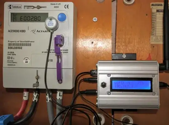

I also had access to some other options - such as a wireless home energy monitor:-
Wireless home energy monitor
I know you say you don't want to hang a clamp off the wires, but this was the option I went for, as it was a heck of a lot cheaper than getting someone to sign off something fancier. And being wireless, you can watch the readings from elsewhere in your home - in my case, I connected the receiver to a computer to record my power usage. However, I remain sceptical about magnetic clamps as a means of sensing, having seen it give nonzero readings before I'd even put the wire into the clamp.

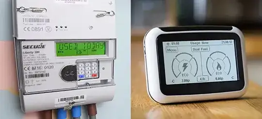

My country also has smart meters with in-home displays - made mandatory by the government, and installed at the power company's expense. So it could be worth checking if your country has a similar scheme. Unfortunately, the smart meter supplied by my power company was pretty useless, which is why I ended up with the current clamps I mention above. Here's a picture of some similar to the ones they supplied me with:
Smart meter and in-home display
Finally, many electricity meters in my country have an an LED that flashes at a rate proportional to energy usage - you can buy an optical pickup that will couple onto those. Unfortunately this didn't meed my needs for solar energy monitoring, as a single LED couldn't give info about electricity import and export at once - but it might work in your case, and they avoid both current clamps and the need to rewire your breaker panel.
Optical pulse energy sensor
