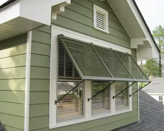

Without a photo, it is difficult to make an make a suggestion, but reading your post reminded me of many, many conversations I have had with people in the past. One of the most popular remedies that was unique but not bizarre was to go to a shortened Bahama style shutter/awning. Color choice on these was key. Here are a few photos. Hope it inspires some ideas.enter image description here
