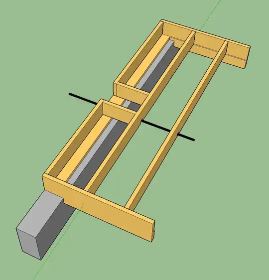

I was running some new gas pipe and I notched one floor joist and drilled a hole in another. I have now learned that this is not appropriate. This was in the forbidden zone of the middle 1/3rd of the joist.
The joist is 7 inches tall and the notch is 1.5 inches tall. I think the wood is redwood. The span is roughly 100 inches. This is an old house, built in the '40s.
  • Here's a photo from the day I made the notch: drilled joist
  • Here's a quick sketch of the situation: sketchup diagram

I've heard that I can glue/screw a 2x4 to the bottom of this joist to make it an upside down T shape. Will this restore enough tensile strength?
A glued and screwed 2x4 fastened to the bottom of the joist would increase the tensile strength. Enough? You shouldn't trust anyones advice on that but a structural engineer, and I'm a different type of engineer. That's not among the fixes I've seen employed in the building trades.
Does this need to be fully-sistered (with the pipe relocated)?
That's one option. There are others.
  • Sister the first unaltered joist, making it a trimmer. Then, temporarily support the 2nd and 3rd improperly altered joists, cut them off on either side of your steel pipe, and run new double 2x8 joists (aka: headers) from the rim joist to your sistered trimmer. Add in the requisite joist hangers, remove your temporary supports, and you're good.
  • Add flitch plates to the cut joists.
  • Add a support beam beneath the two cut joists, near the cut. Voila, now the holes/cuts are no longer in the middle third of the span and the span is roughly half.

These are larger than 2x6 joists. That plays in your favor. A notch in a 2x6 is disastrous. The beams look OK for now. The cracks are horizontal so they're not concerning. Those can be caused by the drying of the boards or settling, and they could predate the notches.
Your best bet is to reroute the pipes and full sister the beam . It has the least questions. If you want maximum peace of mind, go this route. Full sistering involved getting an uncut board of the same width and gluing and bolting it to the damaged beam. Once done, it's just as if you had not cut the beam. A regular pine board should do the trick.
If you want a simpler repair, consider a metal plate (with deep screws) across the bottom below the notch. The hole can likely stand alone (it's close but should still hold) but a metal plate to reinforce can't hurt. Neither is terribly large (as a percentage of the joist)
None of this is urgent (urgent would be a vertical crack), but I would keep an eye on it if you don't repair it right away.
