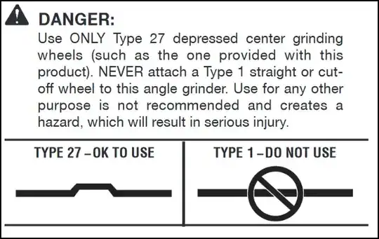

I have a Ridgid angle grinder and a metal cutoff wheel.
On page 7 of the manual it states:
Use ONLY Type 27 depressed center grinding wheels (such as the one provided with this product). NEVER attach a Type 1 straight or cut-off wheel to this angle grinder. Use for any other purpose is not recommended and creates a hazard, which will result in serious injury.
After reading some online forums, asking some contractor friends, and watching YouTube videos it seems that everyone simply uses a Type 1 wheel to cut metal and move on with their life.
PS: I won't acknowledge the countless people that use an angle grinder without the guard. I will absolutely be putting the guard in the correct position.
As far as I can tell I just have to reverse the clamp nut and it securely holds the Type 1 cutoff wheel in place.
Am I using the wrong tool or wrong cutoff wheel or are there simply so many more Type 1 wheel accidents that companies just try to distance themselves from Type 1?
Even the cutoff wheel packaging says "for use with angle grinders" and has a picture of an angle grinder.
Important: I am trying to solicit authoritative answers which can properly explain why one should not use a Type 1 disc. I do not wish for polling answers such as "I've done it so you're fine".

I think I have enough research to make an answer to this. I believe it comes down to the guard available for this tool and it not meeting the requirements for a "Type 1" cut off disk.
This Ridgid forum has what is supposed to be a quote from Ridgid:
The RIDGID R1001 Angle Grinder has an included type 27 guard and is certified to Underwriters Laboratories (U.L.) product safety standards. U.L. requires only type 27 depressed center grinding wheels be used with type 27 guards. Type 1 straight or cut-off wheels have no depressed center posing a safety concern to the operator when connected to a type 27 guard. In no circumstance should a type 1 straight cut-off wheel be used with a type 27 guard. Please contact RIDGID customer for further assistance: 866-539-1710.
This is for a different model, but it does show that they do limit the wheels on their tools based on the guards.

So, all of that points to the guard being the "breaking point" for the type 1 disc support. This is probably because the company had some legal issue in the past so they have decided to officially not support that type of disk with their tools while other brands are happy to sell different guards (speculation alert).
I guess what it comes down to is trusting the included guard to contain the explosion of a cracked type 1 disc.

  • Type 1 cutoff wheels are too close when mounted in a type 27 guard, the wheel can flex into the guard while cutting causing an accident. Type 27 cutoff wheels are common, and offset just like the grinding wheels for safe distance from the guard. – Matthew Gauthier Nov 25 '19 at 22:28
  • @MatthewGauthier Thanks for the input - I was at a home improvement store last night and I did see the offset cutoff wheels. I never knew they existed and had never looked for them because I always reach right for the flat discs. – JPhi1618 Nov 26 '19 at 15:50
  • @MatthewGauthier How would you interpret "NEVER attach a Type 1 straight or cut-off wheel to this angle grinder."? Home Depot also carries type 27 cut-off wheels. – MonkeyZeus Nov 26 '19 at 16:13
  • @MonkeyZeus You should always use the type 27 cutoff wheel. Type 1 wheels are for cutoff tools and may impact the guard on your grinder. Some brands of grinder (like the Makita in this answer) offer an enclosed guard as an option which allows you to use straight wheels. – Matthew Gauthier Nov 26 '19 at 18:00
  • @MatthewGauthier Interesting, I read it as "NEVER attach a Type 1 straight or cut-off wheel *regardless of type* to this angle grinder." – MonkeyZeus Nov 26 '19 at 19:44
  • I think I read it as "Type 1 straight" or "cut off wheel", like that was two names for the same thing. – JPhi1618 Nov 26 '19 at 19:46
  • @JPhi1618 Interesting, you would think they would have wrote "NEVER attach a Type 1 straight (cut-off) wheel to this angle grinder." instead. – MonkeyZeus Nov 26 '19 at 20:02
  • @JPhi1618 I called Ridgid yesterday and the guy basically said "Yeah, don't use those if it tells you not to in the manual, it will void your warranty." So much for that avenue of information... – MonkeyZeus Nov 26 '19 at 20:06
