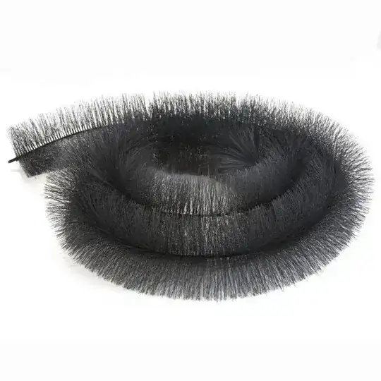

You can buy rolls of 'bottle or bristle brush' type material in different diameters. Essentially plastic bristles with a twisted wire core, simply cut to length and pushed up into place.
Originally designed to deter mice, but it'd work for crickets just as well. enter image description here

  • Where can I buy rolls of this? Googling just brings me to handled brushes. – ACD Dec 02 '19 at 14:58
  • Try "rodent brush" in your favourite flavor of search engine. But, it does look like the suppliers are mostly UK based. I suspect Google tailor my results based on my location. Hopefully you may get different results depending upon your location. I've seen them called 'filter brushes' too... – handyman Dec 03 '19 at 16:26
  • A more time consuming alternative is to use stiff, fine metal mesh (do you guys call it 'hardware cloth'?) and cut it into narrow strips and fold them over to create a kind of mesh angle iron. Push these up into the gap with a drywall blade and they usually grab and stay in place pretty well. – handyman Dec 03 '19 at 16:29

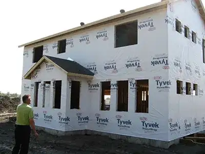

That is 99.456% likely to be a plastic house wrapping such as Tyvek found in this picture:
Source: https://seamlesschoice.com/wp-content/uploads/tyvek-vs-fanfold-insulation-01.jpg
DO NOT seal the bottom with any sort of impermeable caulking nor spray foam. The bottom should remain permeable so that if water gets behind your siding for whatever reason then it has an escape path.
Albeit tedious, you can choose to install that mesh if you wish because it is permeable. I am really not sure how you would attach it to the foundation though.
