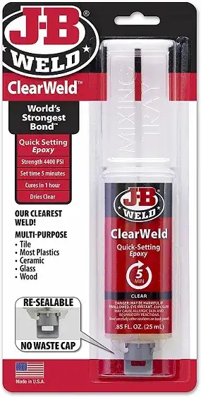

Look into epoxy glue mixes such as:
or
You can read the package or call the company to check if it will work on your specific plastic.
MonkeyZeus
  • 16,461
  • 59
  • These are good products. But I suspect the material I'm dealing with is Polyethylene or Polypropylene, which are not among the plastics listed on the first product, and is generally excluded by the phrase "Most Plastics" on the second. – jbbenni Nov 27 '19 at 15:57
    @jbbenni I see. If you can verify your suspicions then check out https://www.permabond.com/2015/03/31/prepare-bond-polyethylene/ – MonkeyZeus Nov 27 '19 at 16:00
    @jbbenni Also, https://www.homedepot.com/p/Loctite-Plastics-Bonding-System-2g-Super-Glue-681925/100371829 – MonkeyZeus Nov 27 '19 at 16:01
    @jbbenni And http://www.permabondllc.com/TDS/TA4610_TDS.pdf – MonkeyZeus Nov 27 '19 at 16:02
