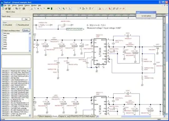

I knew a few EE's who used TinyCAD for circuit diagrams. It might be a little bit of overkill for drawing simpler diagrams though.
The best news is, it's FREE!
Screenshot: alt text

  • Will it do *electrical* diagrams or just *electronic*? – Dennis Williamson Sep 16 '10 at 02:01
    TinyCad will do electrical, but you will have to make most of the library symbols yourself. (Which is easy.) Here is a quasi-electrical diagram I posted recently: http://diy.stackexchange.com/questions/25289/how-can-i-wire-this-three-way-circuit-between-two-buildings-with-only-3-conducto/25523#25523 – Kaz Feb 26 '13 at 10:50
