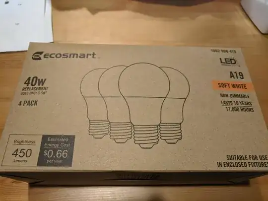

I am trying to figure out if there is something wrong with the new bulbs or the circuit. This is the box that the new bulbs came in.

  • The box says NON-DIMMABLE.
  • You have a dimmer.
