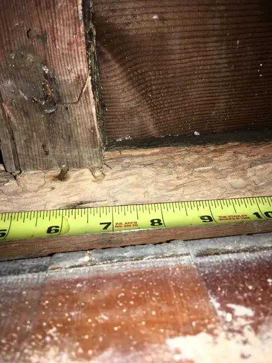

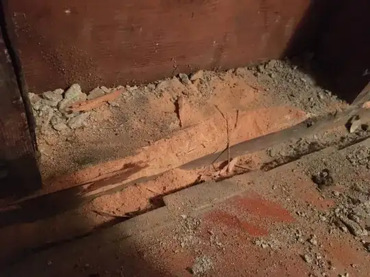

I am removing the lath and plaster (to add insulation) in my 1929 bungalow that I just bought in Portland, Oregon.
Along an exterior wall, the last piece of lath and a little bit of the plate were mostly wood powder.
I scraped away about 1/4 - 1/2 inch of the soft stuff around the corner of the the plate, after that it's solid. The studs also appear to be solid.
My question is, what is this, dry rot? Insect damage?
And what do I do with it? Should I replace this section of the plate? Spray some kind of anti-fungal agent on it? Leave it alone?
If it matters, the house was empty for at least a year (maybe two) before I bought it.
Distance Close up Before I cleaned up the wood powder
Update: I've found this in another room too, in a corner. My best guess is that it simply was dry rot, caused by moisture trapped in the corners. The moisture, I think, was left over from the original plastering of the walls. What I didn't show were large blobs of plaster that had fell behind the lath, and dried on top of the rotted area, getting trapped in the wall. I could be wrong, but everything left is solid and dry, so I assume the rot died a very long time ago.

  • that looks like dry rot ... get rid of it ... it can spread to the rest of the house – jsotola Dec 02 '19 at 05:55
  • That might be the answer @jstola. Seth, what room was this in? It doesn't seem like it saw much water, but could it have seen any? or was there an air passage nearby into this wall space that would allow heat - cool condensate to occur? – noybman Dec 02 '19 at 07:34
  • It is in a bedroom with a south east exterior corner. While I've been demoing, I have found maybe 4-5 lath boards that are similarly rotted. However, this is the only case I've found where the rot extended beyond the lath board. My early assumption was that when the wall was originally closed up, there were a few carpenter ants who were caught inside, except they don't leave dust behind. There are windows nearby, so it's possible that a window was left open or failed at some point, allowing water to enter for a little while. – Seth Dec 03 '19 at 21:48
Pacific Northwest here Corvallis/ Springfield resident for 35 years , I don't see any evidence of ants, termites or beetles our areas chewing pests, it looks more like a fungus or dry rot but is very limited , I would take a screwdriver and press to see if the damage is only on the surface if the screwdriver doesn’t go far it’s only surface damage and a fungicide then a wood treatment to harden and seal the surface should be used. I have found homes that have used the wood Treatment on spongy dry rot , the area sealed and it passed inspection but was noted as a concern, I would probably shim the stud but nothing other than that is really needed from the photo, I might leave it open for a few weeks to see if you do have a small leak and any leaks would need to be fixed but after treating the wood with a fungicide and adding a shim or 2 , I would probably button it up once I was sure there are no leaks into that area if the wood is solid.
I do not believe it is pest based because in all 3 of our normal pests they chew channels and holes not just surface damage that I see. Do this is why I would treat the wood possibly saturate with a hardner based on the screwdriver test.
In my opinion, there is not enough damage there to warrant a concern.
I would investigate a little more to see if there is deeper damage by taking the tip of knife or ice pick to probe and see how solid the wood is with that. To me with the pictures only, it looks very local. Nothing suggests damage could be anywhere else near there. The saw dust in the last picture suggests insects, but the very light wood after you cleaned it up looks like somebody dumped acid there somehow and it bleached and ate up the wood. But that does not seem possible, given it was inside a wall cavity. Insects will typically eat the softwood and leave the more dense rings alone. But it looks like everything was damaged equally. There is no evidence of water damage either that I can see.
Howdy neighbor! I live just up the street (Seattle) in the same Climate Zone 4 that you inhabit.
It's Wood-decay Fungus, which is often colloquially referred to as dry rot.
The most important thing to know about wood is that when it's kept dry (humidity levels < 20%) and out of the path of beavers and fires, it'll last nearly forever. All the bad stuff that happens to wood (fungi, termites, carpenter ants, mold, and other undesirable biologicals) occurs when its humidity rises above 20% (especially above the 40-60% range).
The reason that wood rotted is because it experienced humidity levels above 60% for an extended (months) period[s] of time.
You have a few choices:
  1. Leave it. It's a small patch of wood and it won't significantly affect the structure of your home. So long as you keep the walls dry (humidity < 20%) in the future, the rot will go no further.
  2. Cut out about 12" on either side of the rotted section of the boards and replace. Check the cut ends for evidence of rot. If found, cut out more of the boards until you get back to clean wood. The rot travels best lengthwise in a 2x4 as that is the same orientation as the wood's capillaries that carry water and food up from the roots to the top of the tree.

    It's all good advice, but I disagree with your diagnosis. It looks like wood-boring beetle to me. There appear to be cylindrical channels eaten out of the wood. – Martin Bonner supports Monica Dec 02 '19 at 09:10
  • The discoloration of the wood evidenced in the first photo is not beetles, that's fungal and/or mold. My diagnosis is that the wood was exposed to humidity, which permitted the "undesirable biologicals" to gain a footing. The wood dust in the third photo certainly could be [wood-boring beetles](https://beavertonpestcontrol.com/services/wood-boring-beetles/), but it could also be carpenter ants. When those are present, there's no "appears to be," it's obvious. What do all of the above need in order to eat the wood? Humidity. Fix the humidity problem and the rotting wood problem goes away. – Matt Simerson Dec 02 '19 at 17:48
