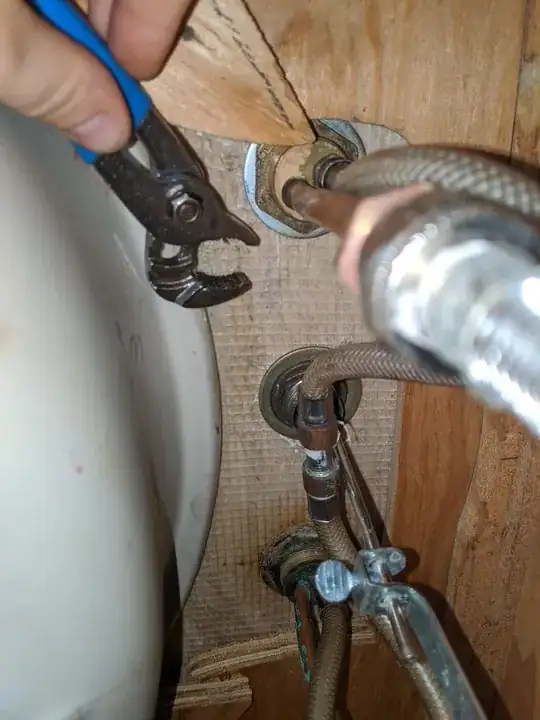

My bathroom faucet is dripping, and I would like to change the washers in it. The problem I am running into is the placement of the nuts holding the faucet valves in place:
underside of sink
This is the underside of the sink, the hot and cold valves are on either side. The nuts holding the valves in are quite large, and they are inside a small recessed space that I can barely fit a small pliers into, much less one large enough to actually get around those nuts. Does anyone have any suggestions for how I might get those nuts off?
Update: Always make sure you are asking the right question first, see answer below. Though if anyone is in a similar situation to mine and actually needs to remove a valve, some of the other suggestions here look helpful.
Joel Croteau
  • 496
    Did you try using your fingers? Sometimes these are simply finger tight, with possibly a thin layer of sealant acting as a compression washer. A bit of wiggling may be all that is required. – Criggie Dec 09 '19 at 10:53
  • Far as I can see, it IS on flexibles. See the silver thing halfway down the RHS of the photo? That's a flexible connecting to a 6-inch copper stub. The two valves are blind -- they take in on the copper stubs and out through the plastic. Two plastics feed into the central fitting, which is probably a swivel mixer outlet with a waste remote lever running through it. In which case, the copper tails are welded into the valves, but the securing nuts are bit enough to go over the tails completely. – Paul_Pedant Dec 10 '19 at 13:32

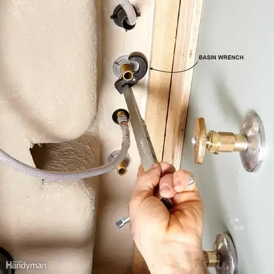

This is exactly the purpose of a basin wrench
basin wrench
Here's a picture from familyhandyman.com that shows a basin wrench in action:
basin wrench
Note that as mentioned in another answer, you usually don't need to remove the faucet to replace the washers; but if you do need to remove the faucet for whatever reason - this is the tool.
batsplatsterson
  • 24,954
    I almost had the opportunity to post my first picture (of a basin wrench) on StackExchange, but batsplatsterson beat me to it. – user116960 Dec 09 '19 at 23:09
  • I think that this answer could be improved with an explanation of how to use it to do so, because I'm looking at the picture and I'm not sure how it works. – nick012000 Dec 10 '19 at 05:34
  • The chrome bit goes vertically up behind the sink. The black jaws are self-tightening (like a Stillson wrench) and go either side of the nut. The joint between the two part swivels, so the jaws can face either clockwish or anti-clockwise on the nut, so you can both loosen and tighten with it. You can hold the top part in place with one hand to get it started, and put a box spanner or similar tube over the lower handle to get extra leverage. – Paul_Pedant Dec 10 '19 at 13:16
    There are also specific socket wrenches that performs this task well (the size of the nut is standard, so you only need the one - **usually**) - google "faucet socket wrench" for a variety of examples. – Stian Dec 10 '19 at 15:02
    Just be sure to refresh your supply of expletives before you start using the wrench. – Hot Licks Dec 11 '19 at 20:28

Maybe I'm missing something here but why are you trying to take off those nuts? The washers for the valves are topside. You just have to remove the valve stems to expose and change the washers. If you wanted to replace the faucet, then you'd need to get these nuts off.
JACK
  • 78,739
  • 72
  • 188
  • If there's a way to get to the washers without removing these, great. The valve handles don't seem to be removable from the top though. – Joel Croteau Dec 08 '19 at 21:18
  • On closer inspection, you are correct. The valve handles are removable, just in a non-obvious way. I think I still need to get a basin wrench or similar though, because the nut on the top of the valve assembly is rusted on, and turning it just turns the whole valve, so I still need a way to hold it from the bottom. – Joel Croteau Dec 08 '19 at 21:32
    Try grabbing the valve body with your channel locks and use an adjustable wench for the nut. – JACK Dec 08 '19 at 21:39
    That is exactly what I needed to do. Thank you @JACK for saving me a lot of unnecessary effort! – Joel Croteau Dec 08 '19 at 21:54
