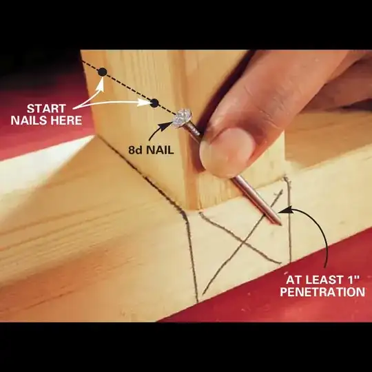

All you will have to do is toe-nail the stud into the top and bottom plates where you want it. It will be cheap (maybe $5?) easy, and secure. You'll want four 8d common nails, two on each side.
Toe Nailing
Toe nailing can be a little frustrating until you get the hang of it, and it can be very difficult if there's limited space. You could use screws instead of nails, but should at least use special "structural screws" or "construction screws" - not ordinary deck screws, and definitely not drywall screws. Since this isn't holding up your house, just your TV, you have some latitude. With screws, you can probably toenail the bottom in place without removing your cove molding.
