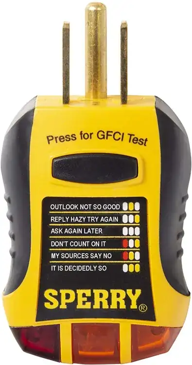

My thinking is I can simply turn off the breaker for those outlets and get to work. But then I thought... what if those outlets are mis-wired? Should I use an outlet tester?

An outlet tester is a great way to determine that an outlet is wired correctly. They are also useful to show that the correct breaker has been tripped before you start working. Take pictures before you disconnect anything so you'll have accurate information in case you have to come back here and ask questions. Follow the directions that will be included with the outlets. Also, make sure none of the outlets are switched as that could interrupt your charging.

  • Using an outlet tester to verify the circuit is dead is a good idea I always use a meter or tic tester (no contact for a quick test) rub it on my shirt it beeps test it should not beep then rub on my shirt again by testing it before and after this method passed local osha inspection.+ – Ed Beal Dec 21 '19 at 21:40
    Outlet testers (magic 8-ball) testers are optimized for new work. In old work, they give very misleading answers, hence my name for them :) – Harper - Reinstate Monica Dec 21 '19 at 21:45
  • I agree with the magic 8 ball name but have never had a false reading if they said the circuit is hot it is , tic testers may be triggered by phantom voltages. – Ed Beal Dec 22 '19 at 01:51

Speaking of testing, those 3-lamp testers have 3 Rather Useful lights which let you do three tests at once. (Obviously, if any lights light, the outlet is most likely hot; but that is not enough.) But the little chart/legend is completely wrong; it's about as useful as a "magic 8-ball". It's actually optimized for new construction; once built, houses have different kinds of problems.
  • However, the GFCI tester function is very nice; if you suspect a redundant GFCI, use the 3-lamp tester's TEST button. It will trip this GFCI (obviously). But if this one turns stone dead and refuses to reset, it tripped another GFCI somewhere else, which means this one is redundant and doesn't need to be a GFCI.
