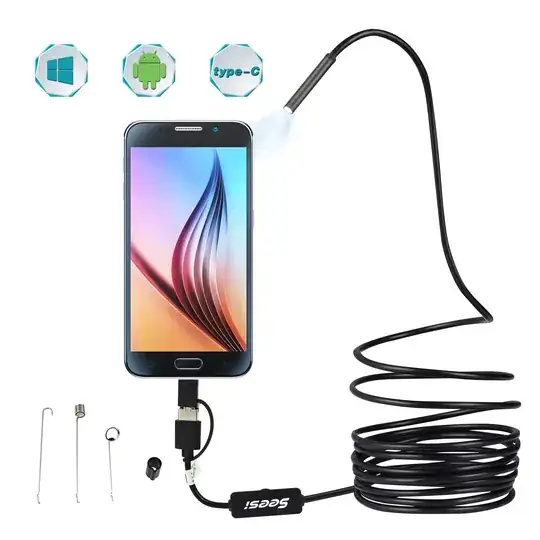

If you absolutely, positively, must know for certain that you've hooked the earring, the whole earring, and nothing but the earring, then you want an endoscope:
an endoscope
An inexpensive USB or WiFi endoscope with attachments costs somewhere around $10 US. All you need to do is connect the endoscope to a phone or a laptop and use it like a webcam. Using the hook attachment, snake the camera into the drain until you see the ring, then hook the ring and pull it out. It could also be used in conjunction with other hooks, grabbers, or even a vacuum.

    lol, there's no way that makes it down into the overflow trap. – LarryBud Jan 06 '20 at 20:03
    Depending on how the trap is connected to the main sink drain, you might be able to push the endoscope in from below, then fish for the ring from above with a wire hook. – ArmanX Jan 06 '20 at 20:31
