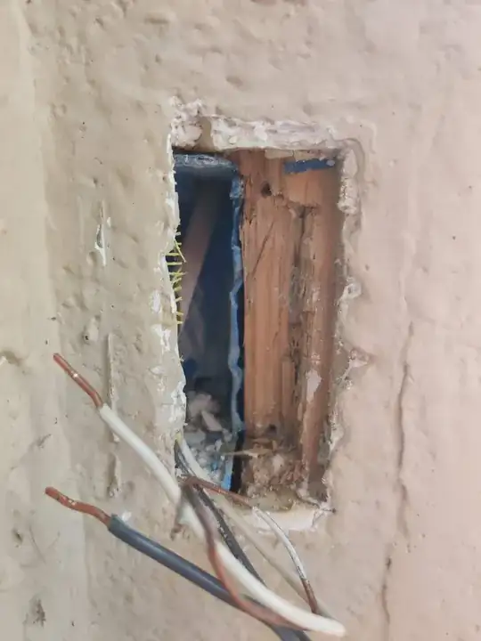

I was replacing old outlet in my house and came across an outlet that is screwed directly into the studs. Also the stud and the junction box were cut to fit the outlet. The new outlet is too big to fit in this space. I am afraid to put a new outlet in here as it could be a fire risk.
What should I do with this? Should i cap off the wires and put a blank wall plate? Or is there some way I can salvage this and put an outlet in here.
outlet enclosure
There is a wall (fireplace) to the left and a sliding glass door an inch or so to the right.

It looks like you are up against a corner on the left, which means you can't simply shift the outlet into the box location. In a perfect world you have enough cable to move the box to the other side of that stud. You would then simply repair your drywall. (We've since learned that there's a door to the right, just out of frame, making this impossible.)
Otherwise I would find a shallow box and cut the stud back so that the box can sit partially or completely in front of it. Since you are right near a corner you can safely take a third to a half of the stud out without concern. It may not strictly meet code, but experience tells me it won't be a problem.
A good way to do that is with a nice sharp spade bit of 1 inch or so. Just make a series of straight-in bores in a grid pattern to cut the wood away. Mark your depth on the side of the stud before hand so you know how deep to go.

    This is what I ended up doing. The stud is an exterior 2x6. I notched it out a little more to fit a shallow box. So it ended up not being that much of the stud percentage wise. – mkuce23 Jan 07 '20 at 03:44

Okay - that is absolutely not to code and a fire/shock hazard. You show an electrical box that is partially covered over by plaster/drywall.
To fix, just cut the drywall off in front of the outlet 1-gang electrical box (the blue box), pop an extender on it to bring it flush with the surface of the drywall (for example), and install the outlet back normally.
By US Electrical code, any place you are connecting wires, you have to have access to that in the wall (e.g. at least a plate covering it, if you have room for a plate - you have room for an outlet). The connection also has to be contained in the box - so the way it's partially covered by drywall is not to code and a fire hazard.

    The primary issue, I think, is that a plate won't fit with the wall corner so close. It appears that the box itself would be aligned with the face of the adjacent drywall, or even slightly behind it. The box needs to be moved, as I indicated in my answer. – isherwood Jan 06 '20 at 16:42
  • Cutting the drywall won't work. The sheets perpendicular to this wall are sitting squarely in front of the edge of the box. You'd have to have a decent sized cut into that wall as well to make it work as-is. – Machavity Jan 06 '20 at 17:13

If you are willing to do a little wall repair, this should be easy to correct, at least as far as we can see. Cut the wall in front of the box and patch the wall over the stud.
Depending on what exact butchery is revealed, you might need a new box, you might not. If you do, just put one in, and patch the wall as needed. Planning to might well be the best bet here, just from seeing the visible-now butchery.

I'd be inclined to saw a notch in the stud and install a proper box. Between a doorway and a corner the stud is not apt to be bearing much weight and can stand to have a notch for a shallow box cut out.
