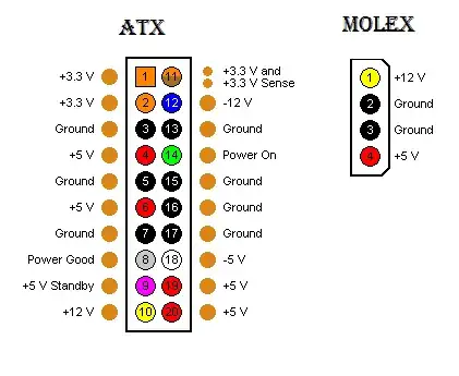

Here is a diagram showing the pinout computer PSU connectors.

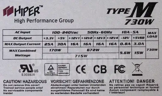

You need to realize you cannot just join all the yellows and use it as one. Each yellow wire is a PHASE and each phase has a maximum amperage rating. All the phases give the power supply its maximum peak rating.
As long as the combined amperage/wattage does not exceed that written on the label of the PSU you will be OK to combine many LED strips to a single phase. But each 5 Meter LED strip will need to be powered individually to be safe. So you need to pull wire alongside all your led strips if you're going to go more than 10M :(
