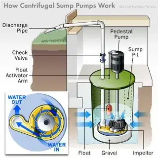

A small submersible sump pump should be sufficient to get a syphon action moving and can be made automatic with a float On/Off switch.
     Basic operation of a Sump Pump
The end of the discharge pipe can be higher than the 'unclean water' depending on the efficiency of the pump but it can always be lower providing that the pump is sufficient to raise the discard water 'over the top' of the highest point of the water's path. Once that occurs, water always flows downhill.
  • You might also consider a small marine 'bilge pump' as an alternative to a conventional home product. –  Jan 13 '20 at 14:36
  • I'm a little confused by the pictures. The sump pump shown in the image will not siphon after it's stopped, since the outlet is higher than the inlet. In the aqueduct picture, there's again no siphon action, as there's no point where the water has to go "up and over" an obstacle. The inclusion of the vents actually make it quite the opposite - if the water stops flowing upstream, the inverted siphon will remain filled with water, and not get siphoned dry like it would without the vents - this is how a P-trap in your plumbing works, which must remain filled with water at all times. – Nuclear Hoagie Jan 13 '20 at 20:26
