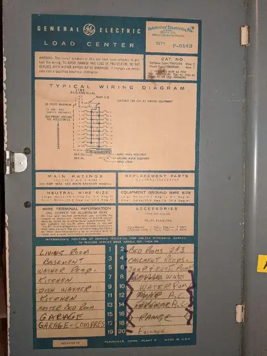

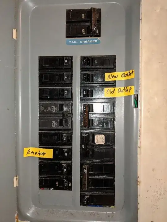

Edit: Photos of the panel showing the which circuits the powerline adapters were/are now plugged in to. Panel label circuits identified

    Which circuit breakers control the two circuits in question? Cut up a Post-it note to make flags, stick them on your service panel to mark the breakers, shoot us a photo of all the switches on the panel, and [edit] it into your question. – Harper - Reinstate Monica Jan 16 '20 at 16:31

  • Update 1-17: Just to clarify these devices did work on two separate circuits (#6 & #13). Taking Harpers suggestion I identified the circuits currently being used and also tracked down the old circuit that worked - see sticky notes on panel. You can see it worked on separate circuits on the same leg but does not work on circuits on different legs. I tried swapping breakers 4 and 6 which would put the devices on the same leg, still no connection.They did connect when I plugged them into two outlets on the same circuit. I'm going to try a few more circuits just to see if they will connect. – Platinum Goose Jan 17 '20 at 20:19

  • On the above pictured panel the alternating rows of breakers are probably on opposite "sides" of the 240v line, meaning that the "old" and "new" would be on opposite sides. – Hot Licks Jan 17 '20 at 22:44

If you're still working on this, look at the circuit diagram on the top of the breaker panel. You can see that the old outlet is on the same power leg as the receiver, while the new outlet is not. I have shown this clearly in the attached image.
There are devices designed to allow this to work, and to not endanger you while you install it. (This one is just the first I found, there are probably cheaper ones.)
In the early days of powerline communications, they just suggested installing a small capacitor joining the two sides of the circuit. It must be able to take 240V, and to be small enough to pass the frequencies involved. Installing it is dangerous unless you are very careful.
